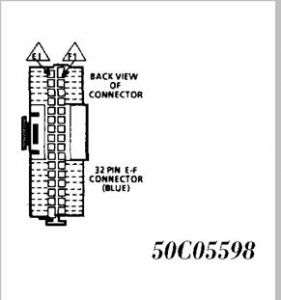

I have replaced my fuel relay plug and relay because my truck wont prime through the relay. If I jump the orange wire to the gray the pump will come on fine but if I hit the key nothing happens. It was intermittent at first but now it just wont prime. There is a green/whte wire and a red wire and a black/whte wire one needs to send a signal to the pump relay to prime and activate but its not, what do I do next?

Welcome to the forum, with the engine cranking, use a digital multimeter, check for voltage at the green wire with white tracer. At key on, no crank, that circuit should be hot for a few seconds.

That reading should be battery voltage. There will be a difference between key on, and cranking, regarding battery voltage.
I'd check the pin at the computer connector for voltage, engine cranking, dark green wire with white tracer. Pin F6-- if good voltage there and not at the relay, problem with the wiring circuit.

This seems very strange but here we go! I unplugged the puter and tested the green/w #6 on blue clip and got no dif. In reading however with the plug out the pump came back on. I then plugged the puter back in and it is working again when I crank it.
However the grn/w wire still say's.02 in the on position during prime, and.15 during crank but the pump is coming on. Now it seems im not getting fuel out the injectors even if you pump the pettle as you crank and hear the pump on.

Hi, I would have left the connector plugged in and back-probed the wire in question. Our database, MOD, says battery voltage on that circuit. The databases are not always correct. There is an oil pressure switch in your fuel pump circuit, parallel circuit to the relay. Once you crank it enough to bring up oil pressure, if there is voltage at the op switch and the switch is function, the pump will get voltage from the op switch and the pump will run, even with the relay unplugged.
If a problem with dark green wire with white tracer, you will not get an initial prime. With an extended crank, the oil pressure comes up, the op switch in the fuel pump closes and the pump will run.

Ok fellas, I tested the green/w wire at the computer and turned on the key -0.03 when I crank the engine no change. Also there is no movement at the rpm needle while cranking? Only if I give extended crank does the fuel pump kick on. But no fuel at injectors. Oh? I left the blue plug in at the puter this time and there is no voltage registering what next?

Hi, check for trouble codes, see if anything shows up? Also, use a noid lite, if you haven't already on the injector plug, see if there is a pulse, engine cranking?
No voltage for the dark green wire with white tracer, at the computer pin. I suspect the computer.
