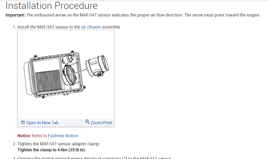

MAF replacement I bought the sensor
JCAROTHERSS

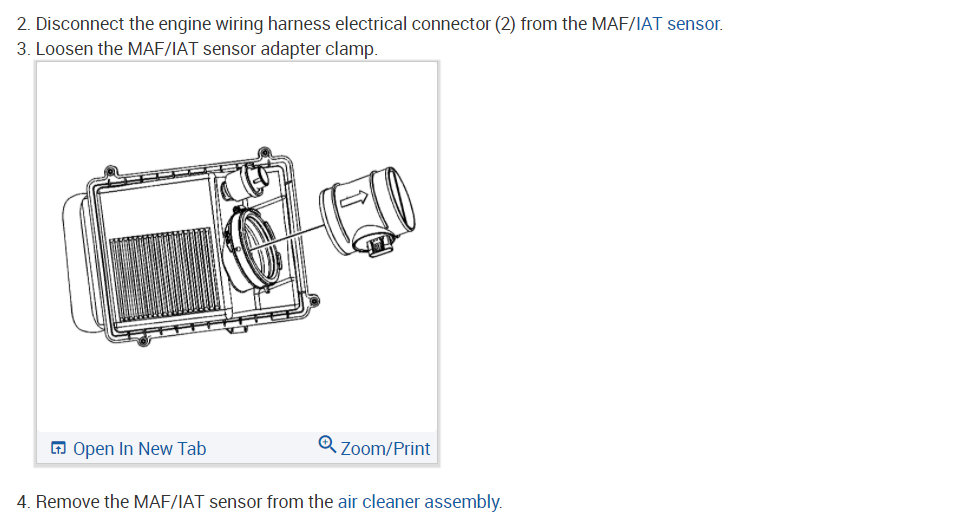

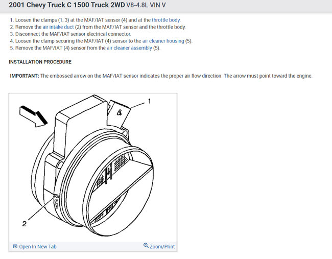

ok i bought this MAF sensor and i tried installing it my problem is i don't know which way it goes can you please help?
Jun 25, 2009 at 2:53 PM
BRIAN 1
  • 1,030 POSTS
Here is a guide to help you step by step with instructions in the diagrams below to show you how on your car.
https://www.2carpros.com/articles/how-to-replace-a-mass-air-flow-sensor-maf

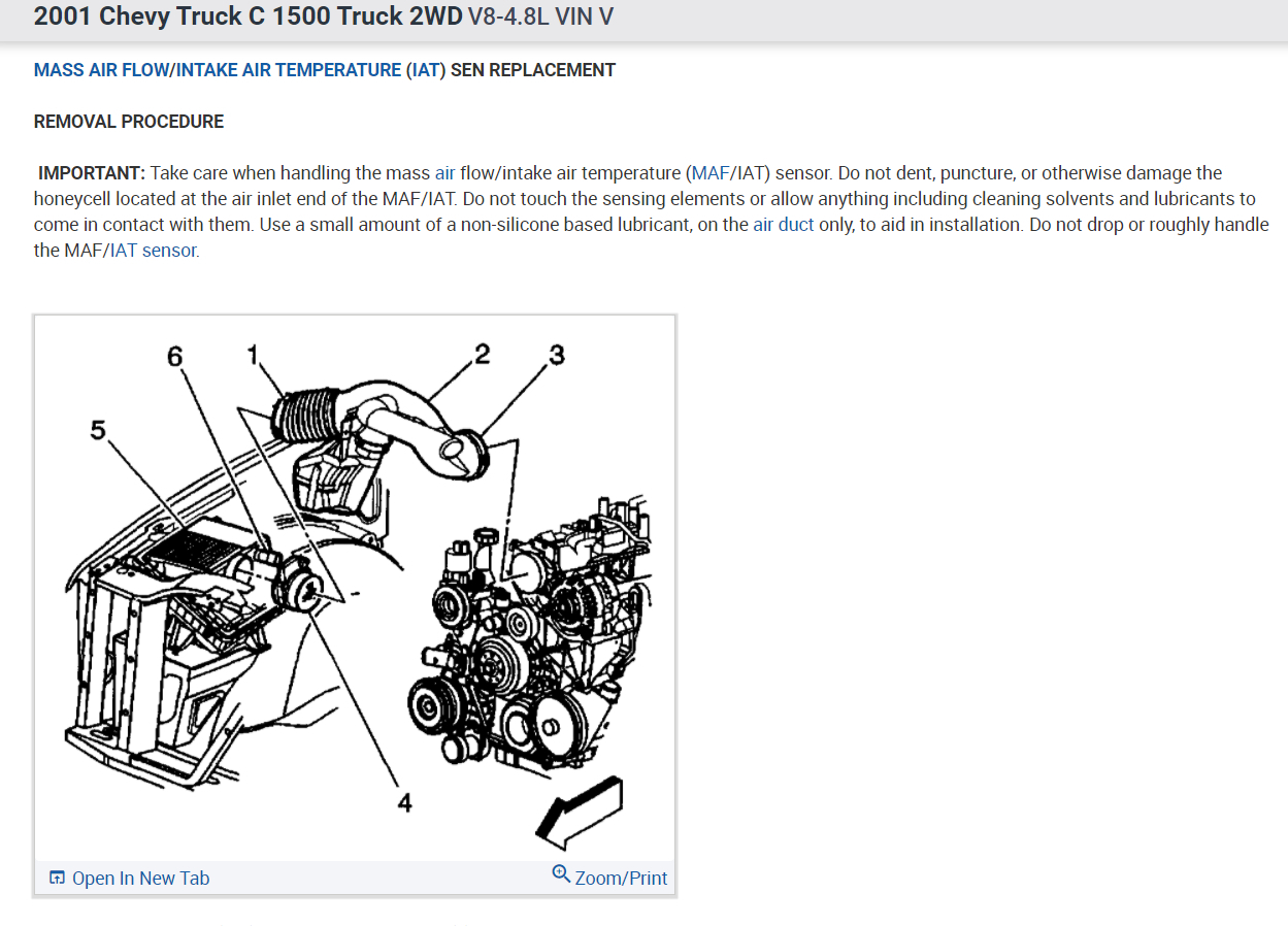

The Code P0101 is a clue the MAF sensor can make the truck run poorly and cause the additional codes. Here is a guide to help you step by step with instructions in the diagrams below to show you how on your car:

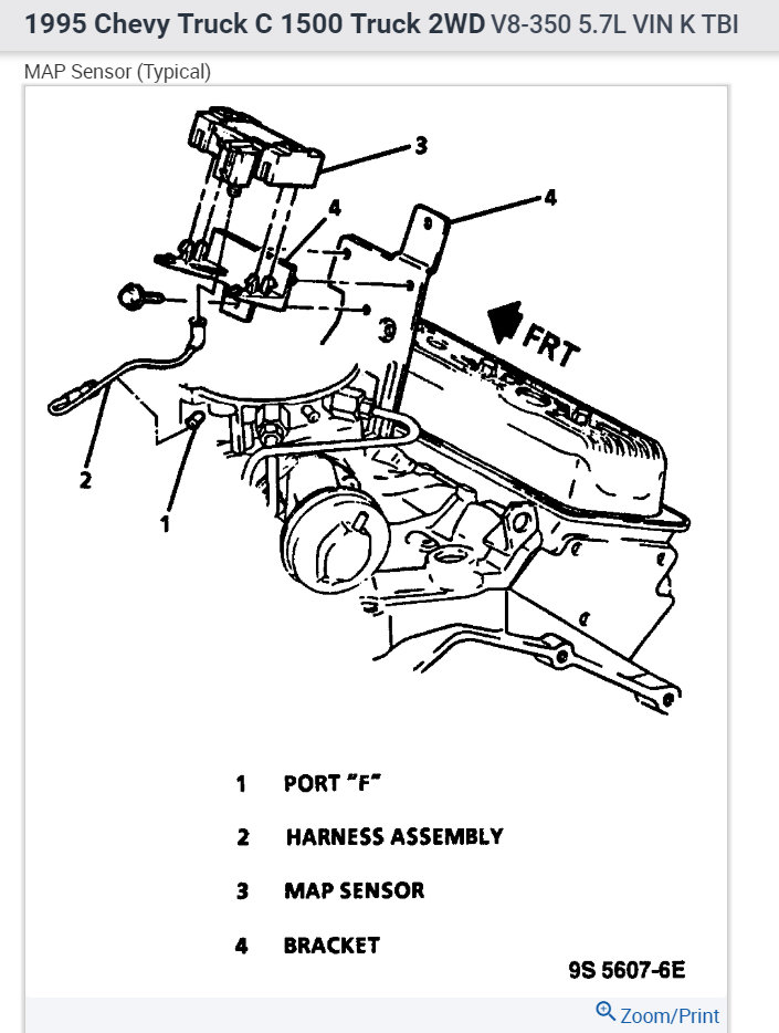

JMERIDETH42
How do I replace the Mass Air Flow Sensor on a 1995 Chevrolet 1500 5.7-L 2-wd pickup?
May 12, 2021 at 6:45 AM (Merged)
DWB812

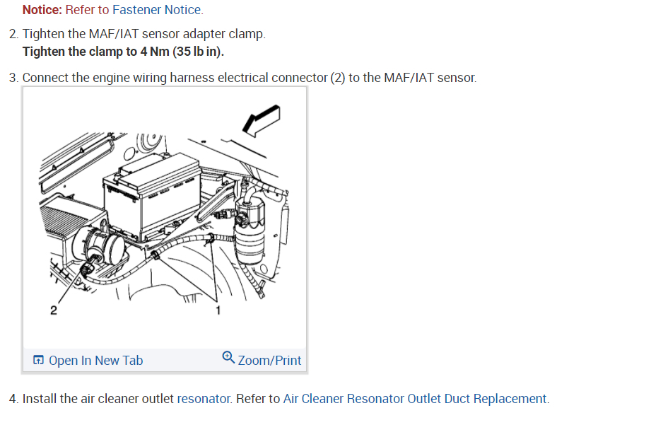

  • 108 POSTS
Here is a guide to help walk you through the steps and diagrams below to show you how to replace the MAF in your truck but you truck has a MAP sensor which is different.
