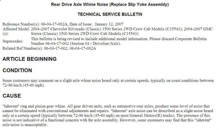

hello, my chevy truck started making a squealing noise only once warmed up, and only in gear while cruising, if you let off the gas it goes away, if you put on the gas it goes away. It will make it at almost any rpm, but only while cruising. It will not make the noise in park, neutral, I think it maybe associated with the tranny since if you put it in neutral while cruising the noise goes away, It shifts fine, and is full of new fluid. The noise is pretty loud.

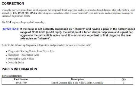

This is a diagnosis that may need a set of chasis ears installed to narrow down the source. Transmission sounds reasonable, but a noise can resonate. There is a technical service bulletin about a whine that GM appearently is unsure of....
https://images.2carpros.com/forum/automotive_pictures/30961_qsil_1.jpg
https://images.2carpros.com/forum/automotive_pictures/30961_qsil1_1.jpg
This was date in 2007. The same tsb was issued in 2005 but said to replace the axle... You may also be able to replicate the noise on a lift and use a stethescope to narrow it down. Need to narrow down the source to better continuing troubleshooting.
