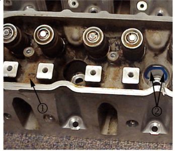

hey guys got an anti-freeze smell that started recently after i've been driving. not seeing any leaks but i'm having to add anti-freeze only every once in a while. is this something that is being seen on this model truck?

pull the valve cover off and check the cylinderhead around the head bolts for coolant leaks,very common.Some vehicles may experience a gradual coolant loss over time. A very low percentage of cylinder head(s) manufactured with an embossed Castech logo may develop a porosity crack in a very specific area. Inspect the cylinder head assembly to determine if the casting was manufactured by Castech. This can be accomplished by inspecting for their casting logo located on top of the intake port, under the rocker arm support rail and in the spring deck cavity portion of the cylinder head. If the cylinder head(s) are Not a Castech casting, follow normal diagnostic procedures in SI to determine the cause of the coolant loss. Refer to the illustrations on how to identify Castech casting and/or the very specific areas of the cylinder head(s) for a coolant leak from porosity. Cylinder head(s) location of the Castech manufacturing casting logo (1). Close up view of the cylinder head(s) showing the Castech manufacturing casting logo (1). If the cylinder head(s) is a Castech casting (1), inspect the area around the five oil drain holes for witness marks indicating coolant seepage over time (2). If No evidence of coolant loss is found on inspection of Castech casting cylinder head(s), follow normal diagnostic procedures in SI to determine the cause of the coolant loss. The crack location can be found in any of the five cylinder head(s) oil drains. This can be seen as a clean or shiny area, on an otherwise stained surface (1). Pressurizing the cooling system at this time may reveal coolant, air, or a combination, weeping in the described area. If inspection reveals evidence of coolant witness marks (1), replace the entire cylinder head(s) assembly.
https://images.2carpros.com/forum/automotive_pictures/147643_cylinder_1.jpg
