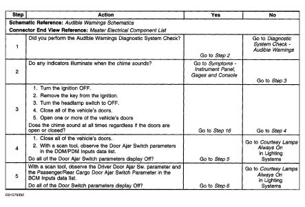

I am get a chime going off. It goes off 4 times (bing, bing, bing, bing). No lights on the dash go on with the chime, and it goes off for apparent reason.

Some models will chime for the seatbelt, even if they are connected.
Other possibilities are maint, like oil, or low tire pressure, but you should have a light on.
Check owners manual on procedure to reset maint. Light, see if chime goes away.

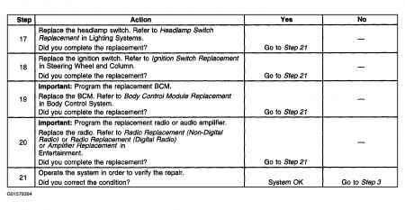

It is a seatbelt reminder.
Chime testing:
https://www.2carpros.com/forum/automotive_pictures/108325_chime_1_1.jpg
https://www.2carpros.com/forum/automotive_pictures/108325_chime_2_1.jpg
https://www.2carpros.com/forum/automotive_pictures/108325_chime_3_1.jpg
