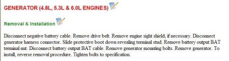

2002 Chevy Silverado How to replace an alternator on an 02
KDONAHO
MEMBER
2002 CHEVROLET SILVERADO
Electrical problem
2002 Chevy Silverado V8 Two Wheel Drive Automatic
How do I replace the alternator?

Which engine size? 4.3L, 4.8L etc?

5.3 V8
