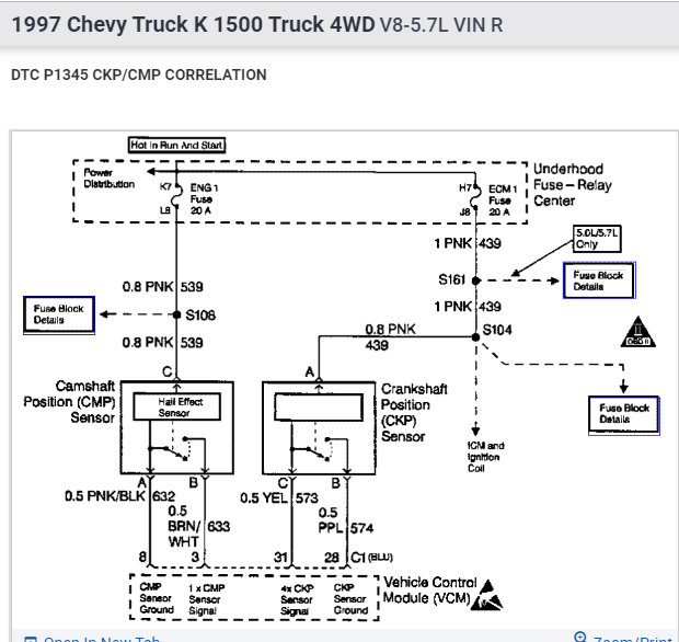

Check engine light keeps coming on, code is P1345, ckp/cpm corolation problem, checked wiring and fuses can not seem to get code clear. Wondering what causes this code

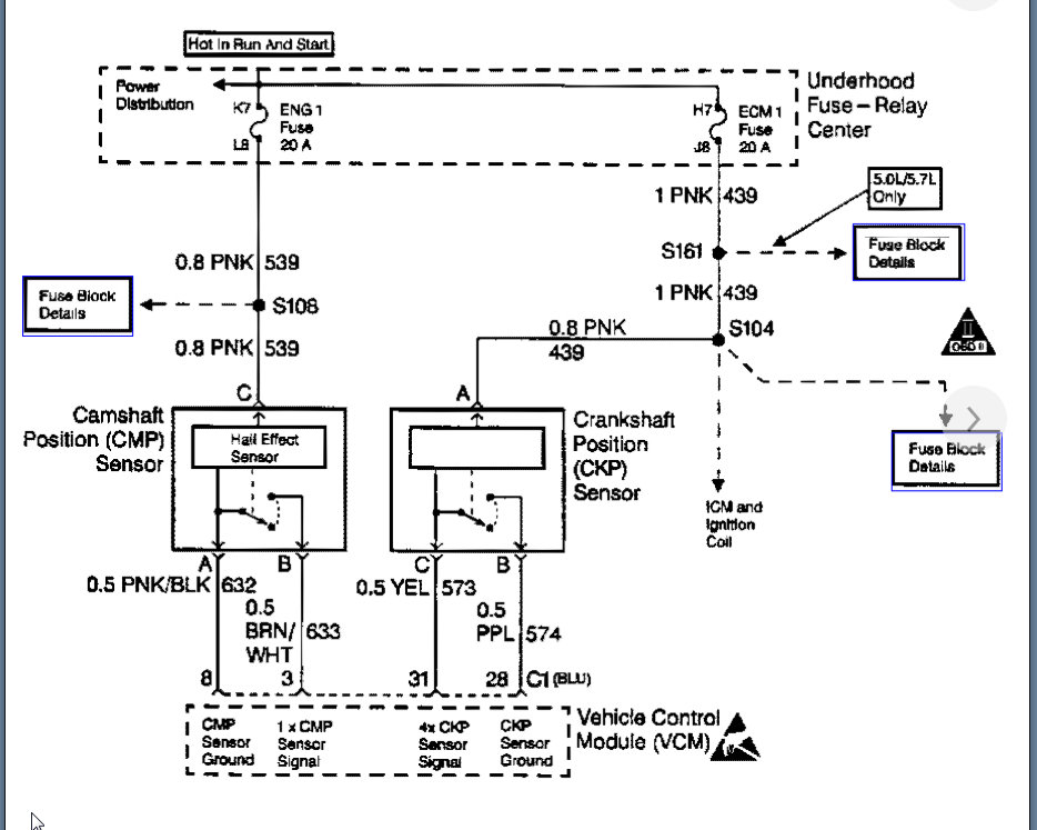

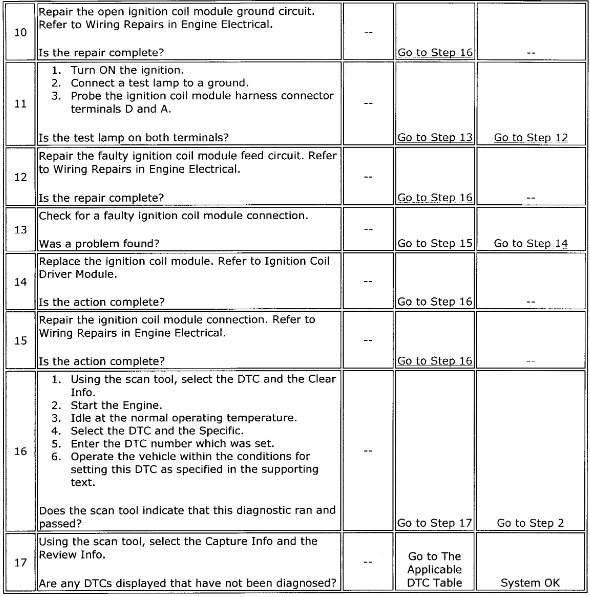

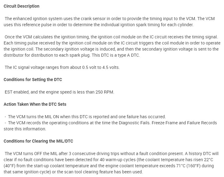

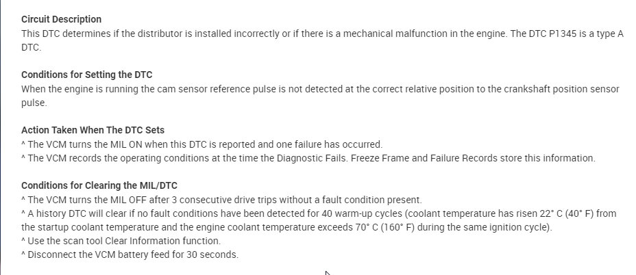

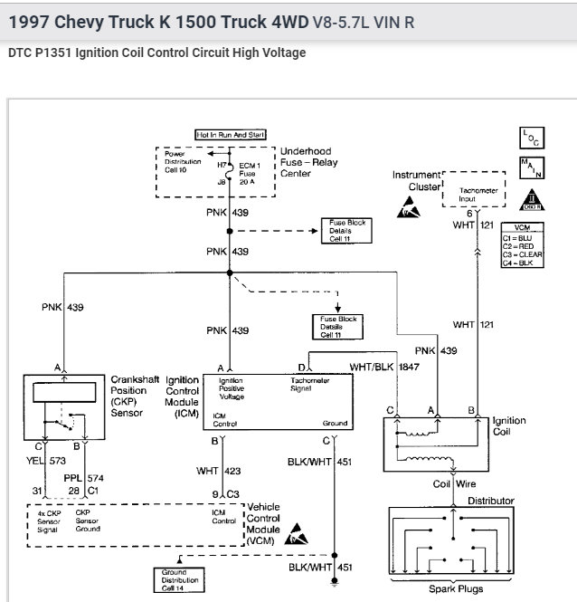

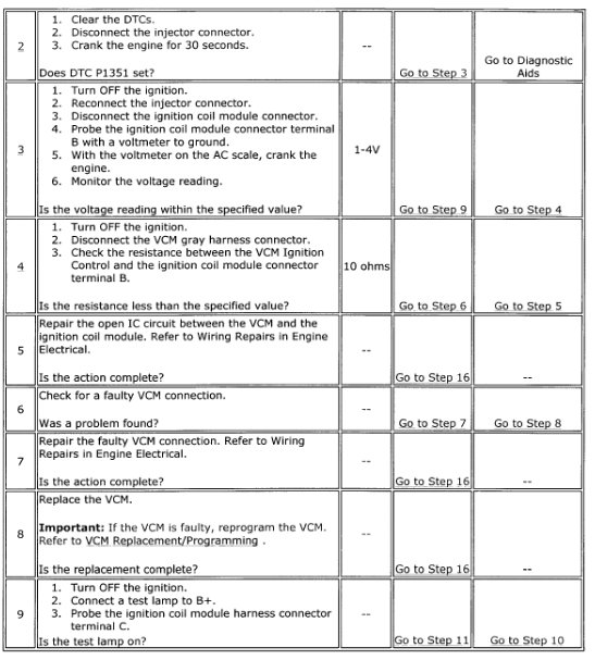

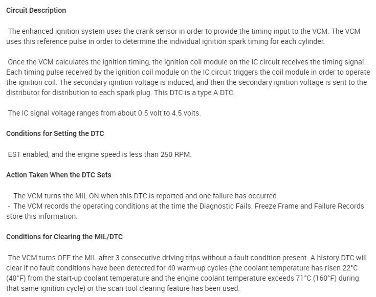

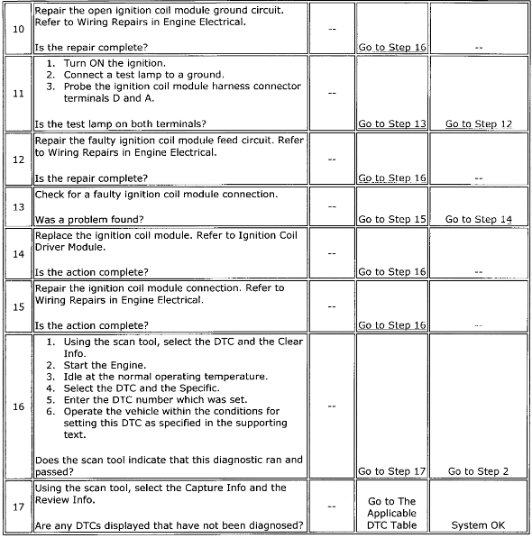

The code P1345 is for Crankshaft/Camshaft correlation and code P1351 is for Ignition Coil Control circuit high voltage. Here is a tutorial on how to test your trucks wiring:
I've attached step-by-step instruction pictures for your truck below to help get started diagnosing your vehicle.Hope this helps and thanks for using 2CarPros.

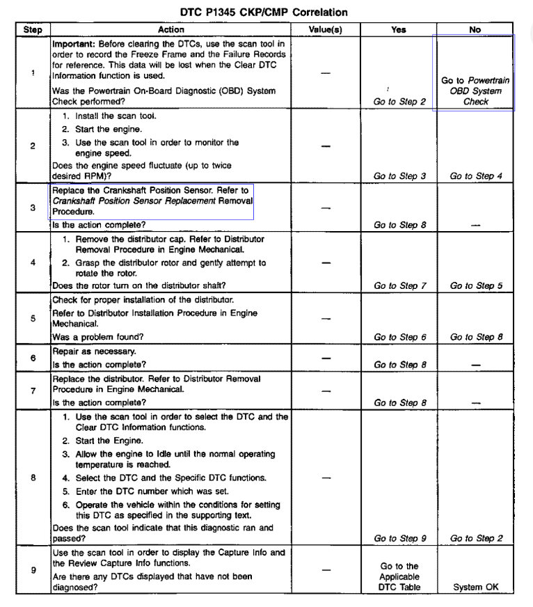

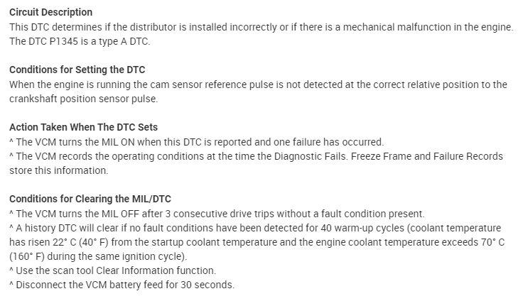

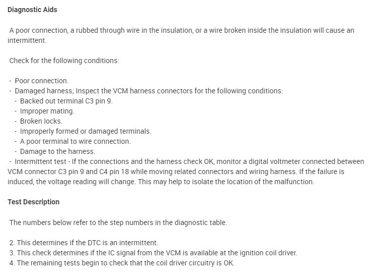

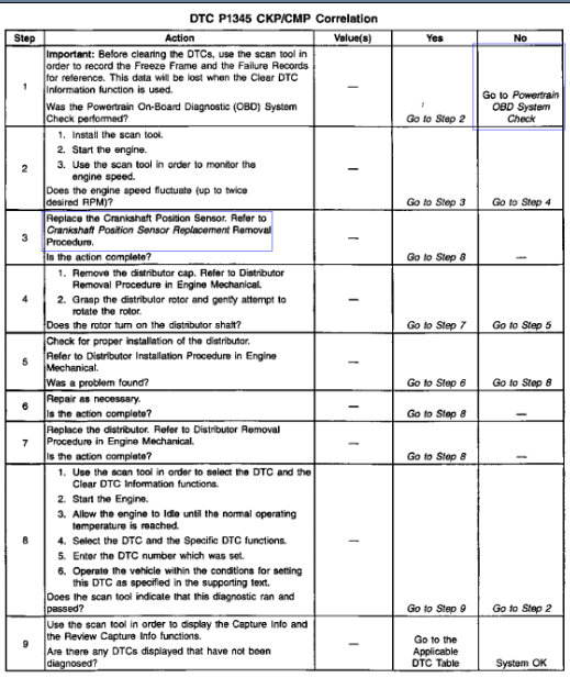

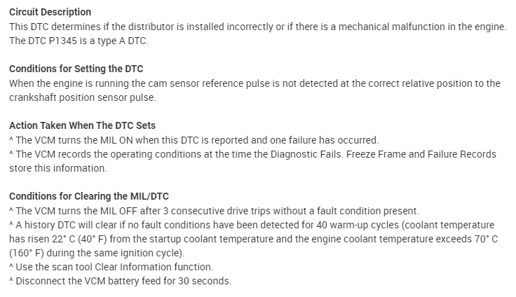

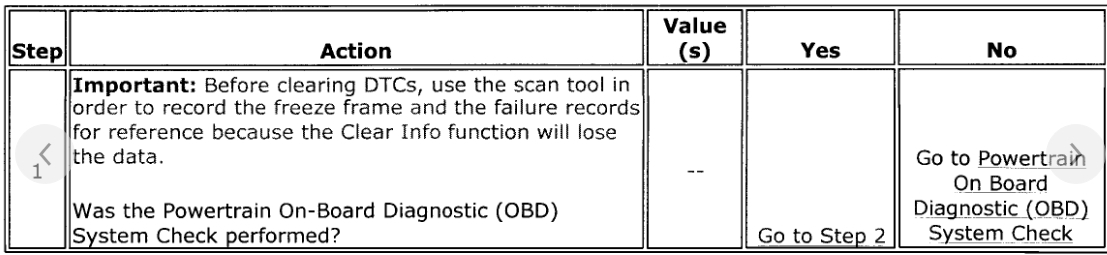

Here is the diagram information for this code. Based on what was replaced, I suspect you will find the crank sensor is the issue (step 2).
Basically this code is saying that the cam shaft and crank shaft sensor are not telling the computer the engine is moving at the same speed.
Let me know if you have questions but I think you will be on the right path after reviewing this material and following this test. Thanks

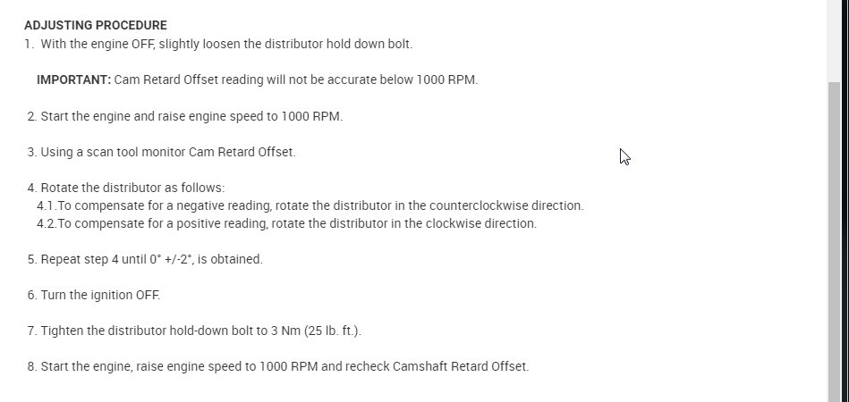

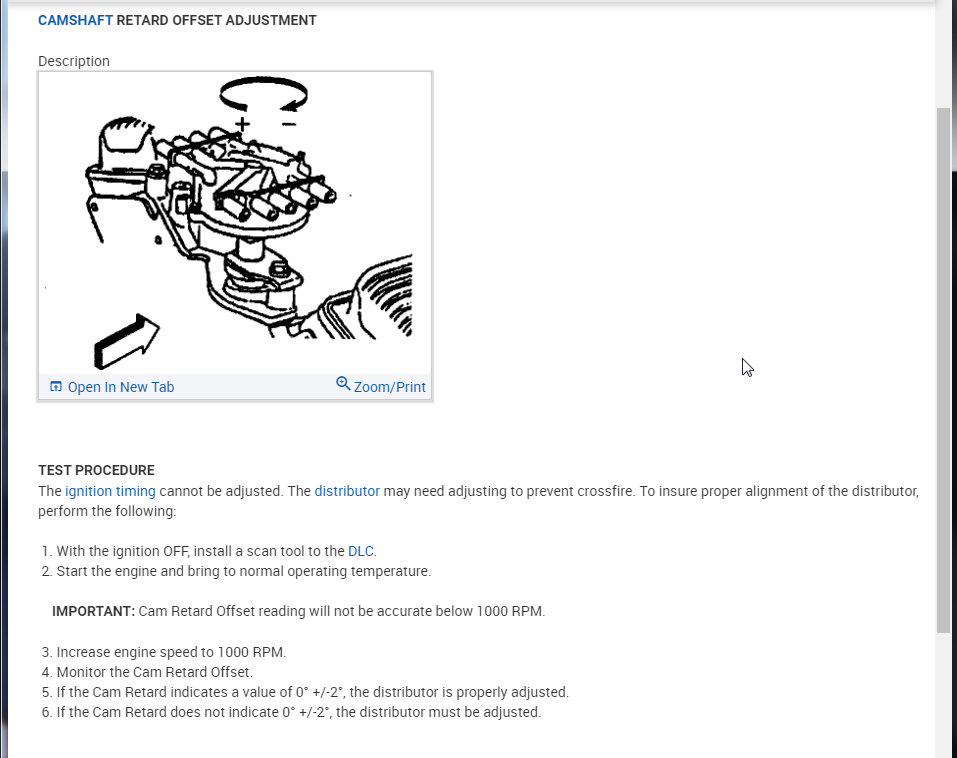

First thank you very much for your time, it is greatly appreciated. I am going to follow what you gave me as soon as I get home. I do have a question though, about the distributor adjustment process. Is it true that the only way to get the truck timed correctly is by using a scan tool capable of reading and showing the cam retard in degrees and getting it within +, - 2°? Am I going to have to have that done? Or should I? Thank you again for your time and expertise.
Thursday, May 6th, 2021 AT 1:55 PM (Merged)
Sounds good.
Yes. You pretty much nailed it as regards to the timing. Attached is the procedure.
I would have this checked but normally you would have more than just the CMP/CKP correlation code. You would have this code but other timing codes to go along with it. Checking it is always a good idea.

Sounds like you installed the distributor incorrectly.

The wiring diagram isn't going to help you. The problem is the distributor is installed incorrectly. You probably tried to use a timing light to set it and that can't be done. You need a professional scan tool that can read the cam/crank offset. The problem is the cam sensor in the distributor is not synched with the crank sensor signal. There is a PID in there that reads offset and it needs to be set to zero or very close. Anything over 4 degrees plus or minus with set that code.

That's a starting point but you need to fine tune that with a scan tool.

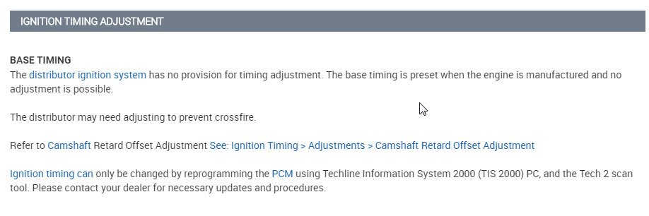

Wrenchtech, I have done what you have said to do, Now my question is, The timeing is set at TDC, The scanner is showing 22 deg after TDC, I was able to put a timeing light on it, It is showing about an 1 1/2 inch before TDC. Any sugestions about what to do with it.

Nothing at all. The timing is not adjustable, cannot be changed and controlled by the computer.

You cant change the timing. Turning the distributor only changes the synchronizing of the cam sensor, not the timing. If you have a misfire issue, look elsewhere.
