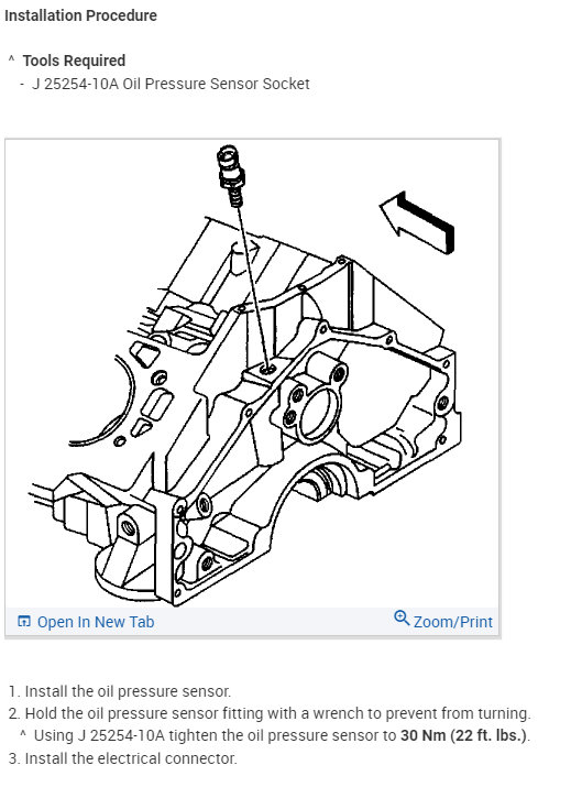

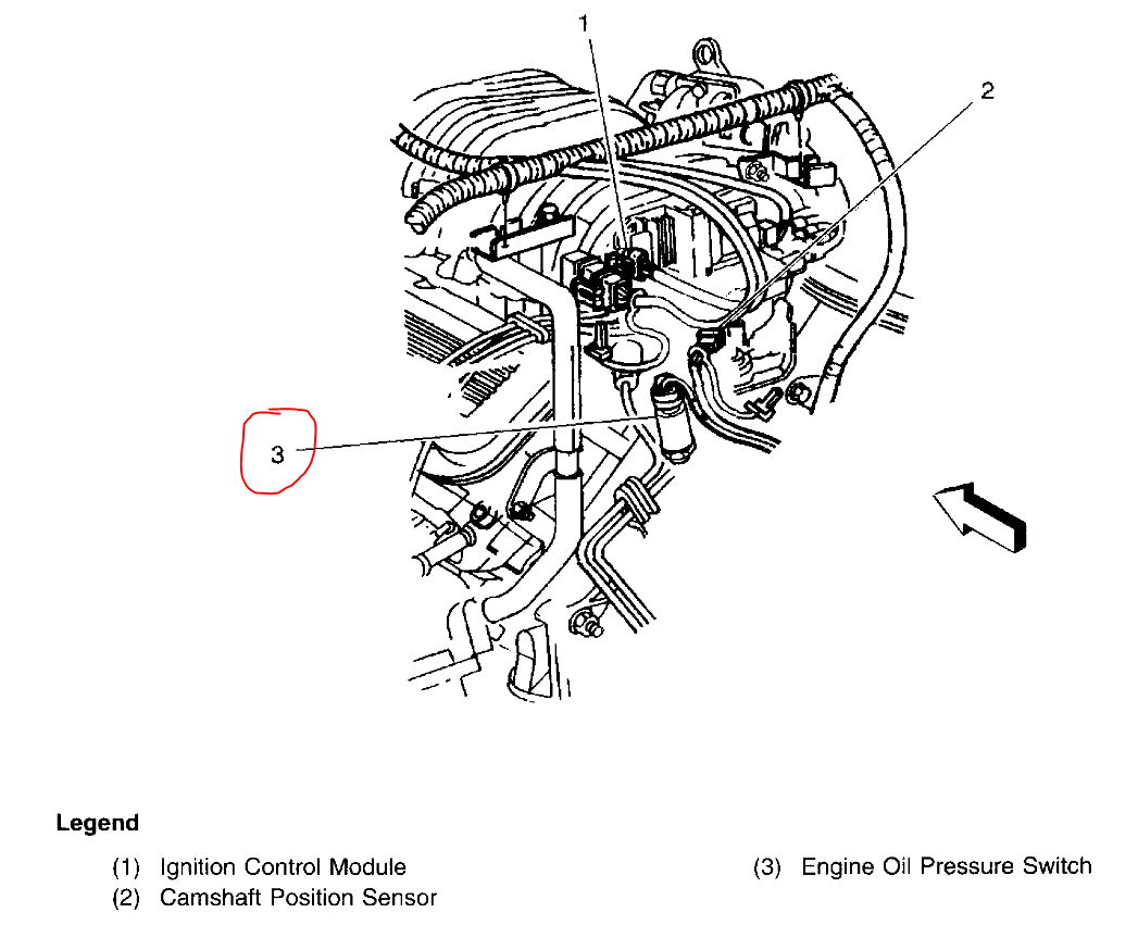

I have a 7.4 L vortex v8. The OPS is at the back close to the firewall. It cannot be seen by eye, just felt by hand. It is a plastic housing and it broke at the metal base. What size socket should be use to get it out. It seems that a socket wont get fully on it. If so what can be use or is there a special (becoming more common) tool to use to get iit off the engine.

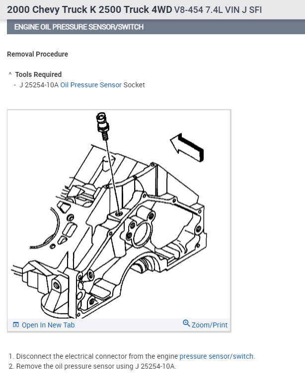

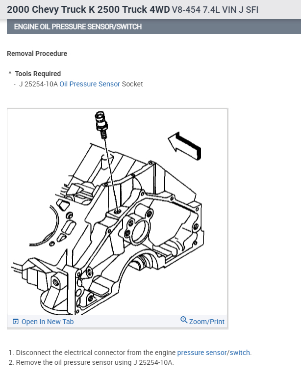

There is actually a special tool (large socket) to remove those sensors. The part # J 25254-10A , for the socket.
It is a 1-1/16 inch deep well socket.
