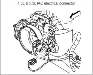

My truck shuts off when I take my foot off the gas to put it in drive. Could this be due to a fault or dirty Idle Air Control Valve/Motor? If so, can you tell me how to locate it on my vehicle?

You may need to clean the throttle-body. The valve is mounted to the throttle-body.
