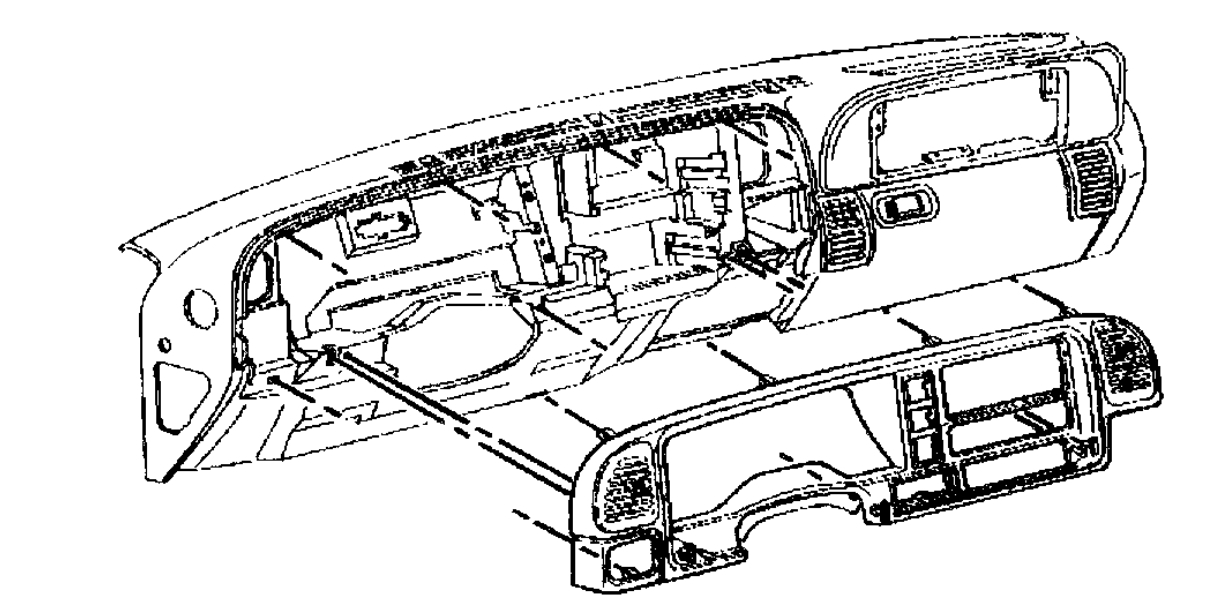

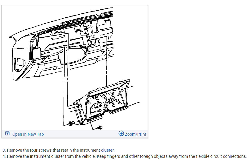

I have seen the cluster short out and caused this but I have also seen the PCM have problems as well. We need to get he codes to see what's going on, here is a guided that will help
Here is how to remove the cluster so you can get another one of have your rebuilt if a code comes up for it. Check out the images (below). Please let us know what happens.
