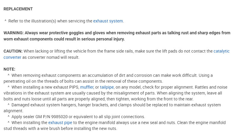

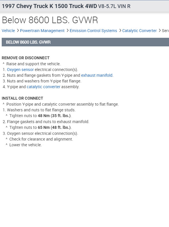

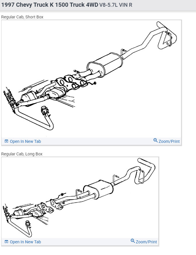

This does sound like an exhaust restriction, possibly clogged converter as stated by Bobb.
Here is a guide to test the converter:
I have also attached replacement instructions for anyone might be looking to do the replacement.
Any questions please let us know.
