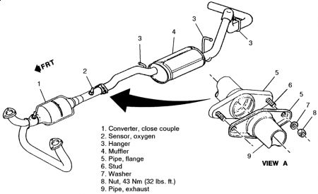

I recently replaced the catalytic converter and I noticed something unusual. The catalytic converter was behind the muffler instead on in front. Is this the correct placement of the catalytic converter? If not where should I place it and should it before or after the oxygen sensor? I guess all I really need is a picture or diagram of the original exhaust set up should look like. Could you please help me with this problem?

Hello Art Prado The catalytic converter first, then the oxygen sensor, the muffler and at the end the exhaust pipe.
https://images.2carpros.com/forum/automotive_pictures/46384_0900c1528008ef73_1.jpg
