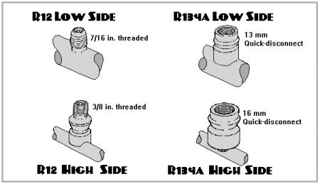

Doe your fittings looks like this
https://images.2carpros.com/forum/automotive_pictures/12900_ac_service_fittings_1.jpg
The LOW side fitting is usually located on the suction hose or line that goes from the accumulator to the compressor. The HIGH side fitting is located on the line that goes from the compressor to the condenser
