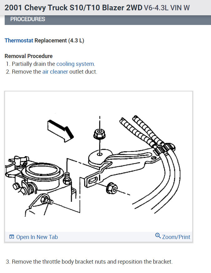

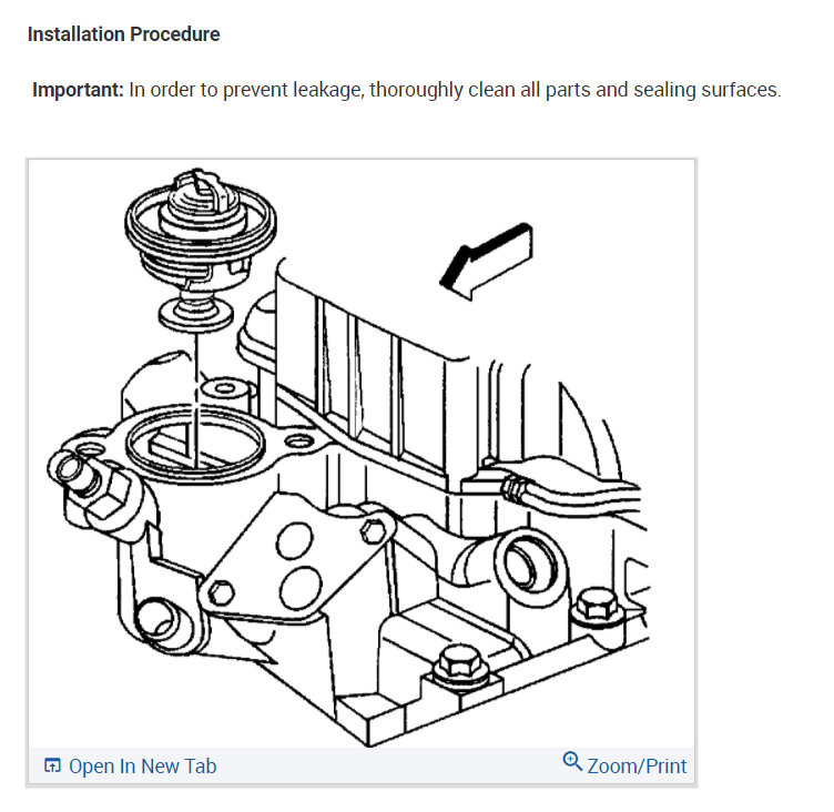

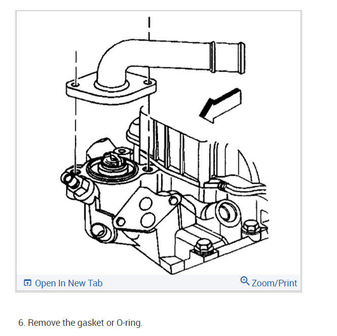

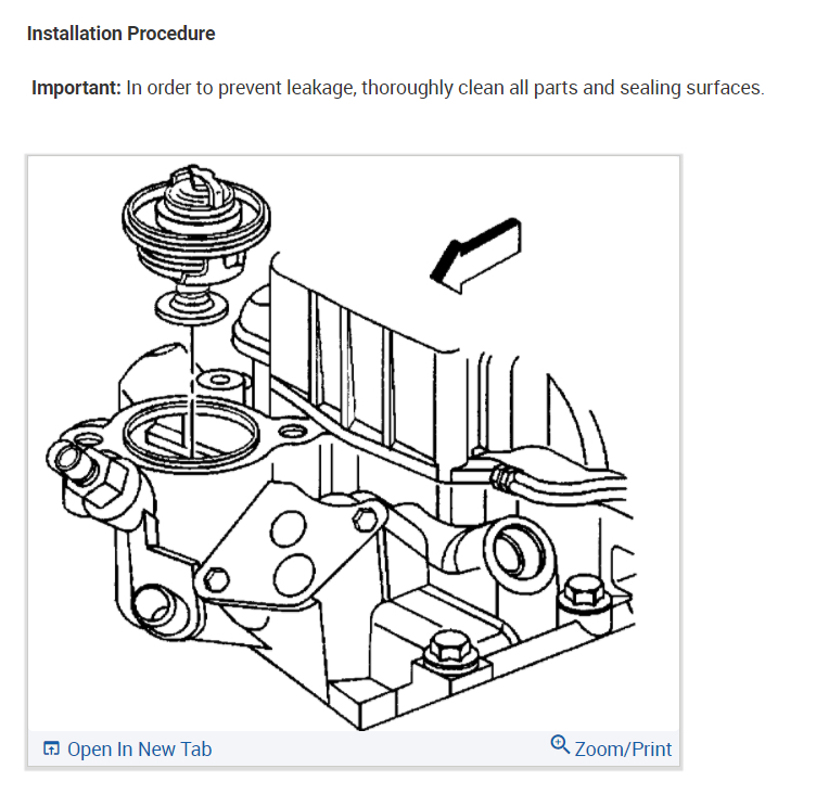

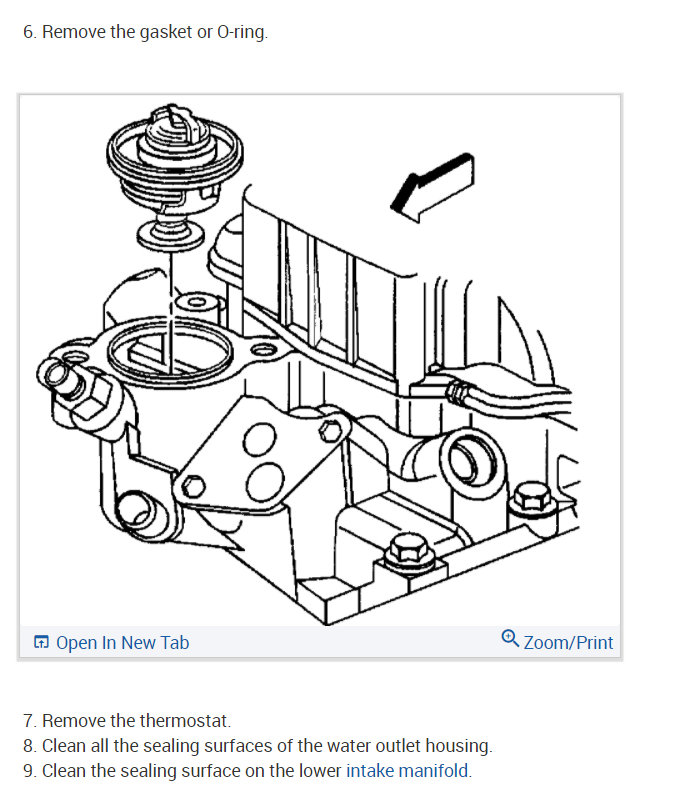

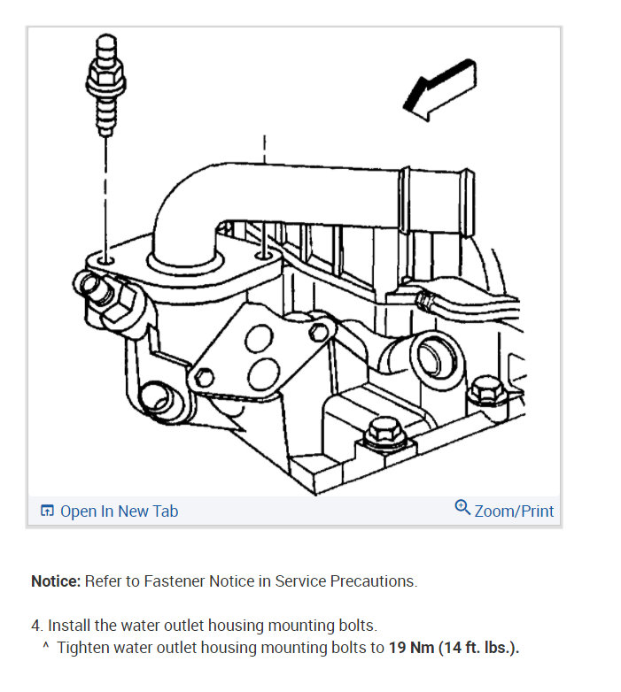

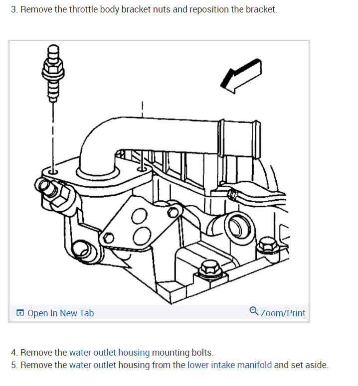

Within the last thirty days, I have had intermittant problems with the truck starting. I may get in and it won''''t start, and then start fifteen minutes later. Or i may drive it somewhere, and then it won't start. Then it's Perfect for a week or so .I have a person eorking for me who Thought it was the starter, but it makes no sound if it won't start.He had the battery tested, and it was low,which I was planning on buying a new battery. then today he drove it no more than 3/8 of a mile, and told me he wanted to replace the thermostat because he said i the gauge should register about 195, and it had barely moved. Help?
Dec 13, 2008 at 11:07 PM
BLACKOP555
  • CAR REPAIR CONTRIBUTOR
  • 10,386 POSTS

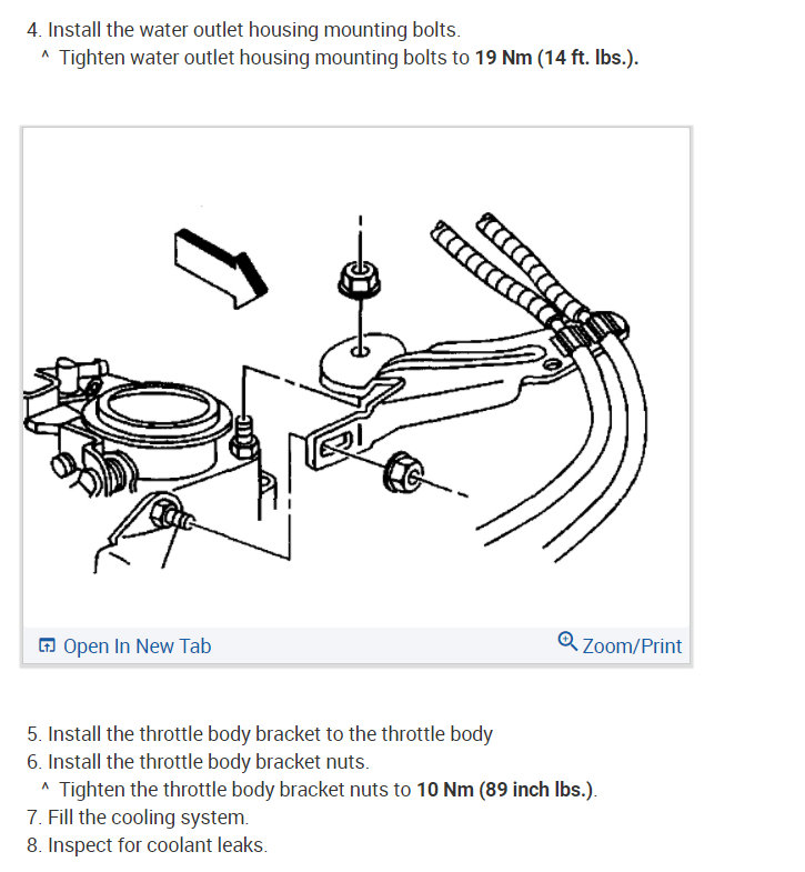

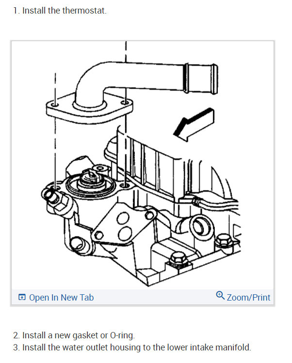

Here is a guide to show you how to repack the thermostat step by step with instructions in the diagrams below to show you how on your car.
