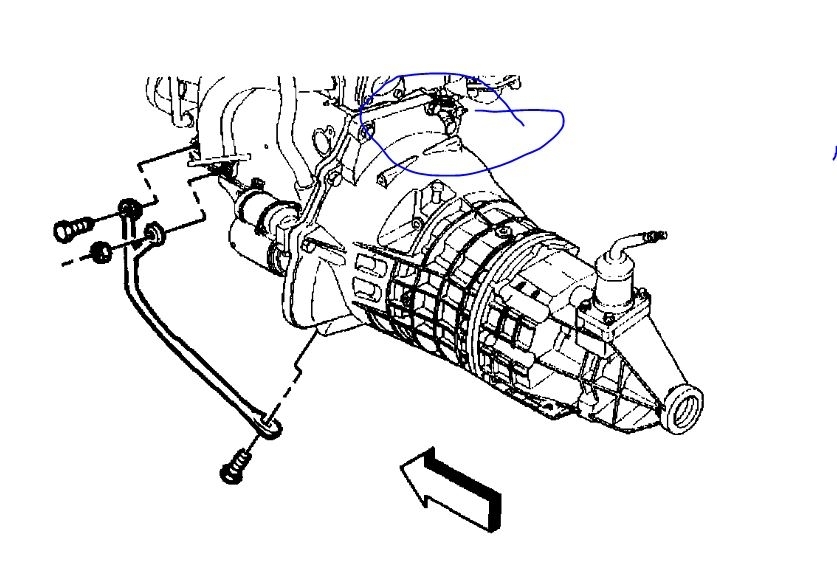

I have a 2000 Chevrolet s-10 pickup, manual transmission with 89,897 miles on it. I just replaced the hydro clutch in it, engine was performing great prior to change of clutch. There are no leaks that I can see or smell, but when I went to start the truck it isn't firing. Pulled spark plug wire to trouble shoot with screw driver test, not throwing spark, fuel not spitting. I'm thinking I have air some how in the line, maybe damaged when moving the transmission to replace Hydro Clutch. any suggestions?

who did the clutch? they may have missed a ground wire on the bell-housing.

that still would not explain the no spark. i think it may be as mr. Chev says. he may have forgotten a ground on the vehcile causing it not to complete the circuit.

Good evening,
You need to check the ground wires at the bell housing. There are 6 bolts that attach the bell housing to the engine. The top bolts usually have a ground wire attached to one of the bolts. That is for the power train system and will shut off spark and fuel.
