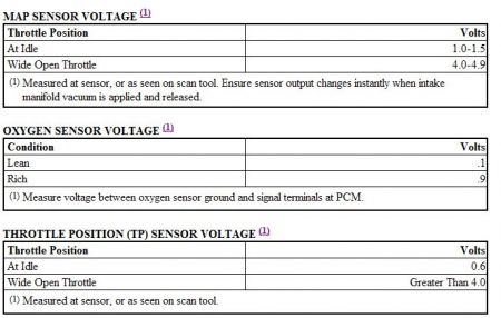

With the DVOM you're looking for a smooth rise and fall of the resistance. For some reason I can't bring up the pin connections and ohm readings. I'll try again in a bit. Attached is the voltage readings.

I checked and I do have a bad spot in the TPS. However I also hooked up a fuel pressure testor and when I prime the pump, I get 60psi. Then when the pump shuts off, it drops to 0 psi real fast.

Yes it jumps right to 60 psi. Actually, I replaced the TPS, and it was bad, but it did not fix the problem. I also decided to clean the MAF. It Fixed the problem. I still think there is a problem with the fuel system not holding pressure but It runs good and I will address the fuel problem if it starts causing problems.
