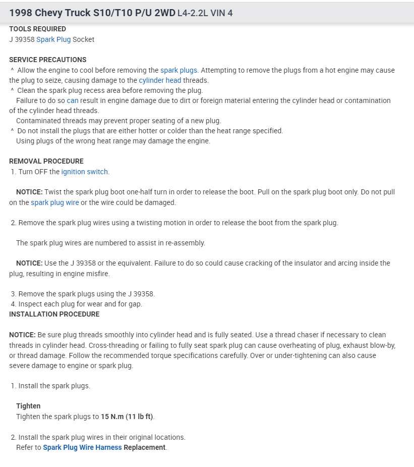

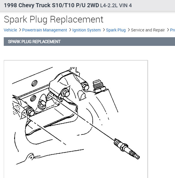

I need to replace my spark plugs. But the a.C. Compressor is in the way, of 2 of my plugs. How can I do this without removing the compressor fits a 98 s-10, 2.2 4cyl thank you.

In order to access the spark plugs, you will have to first remove the air intake tuning out of the way. This will give you just enough room to work with. You will need an extension to be able to get the spark plugs out.
