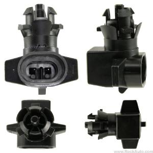

I would like to know where the Ambient Air Sensor is at on a 1998 Chevy S-10 and exactly how to replace it.

The Ambient Air Temp Sensor is located in one of two spots depending on weather or not you auto A/C. So with auto A/C it is located on the right side of the radiator support baffle. Without auto A/C it is located in the front center of the truck near the hood latch. Hope this helps.

I checked the side of the radiator and found nothing. I have also checked the front between the radiator and the grill. Do you know of anywhere else that the Ambient Air Sensor may be.

It is below the left turn light on the radiator support baffle. Here is a pic.
https://www.2carpros.com/forum/automotive_pictures/249564_sensor_1.jpg
