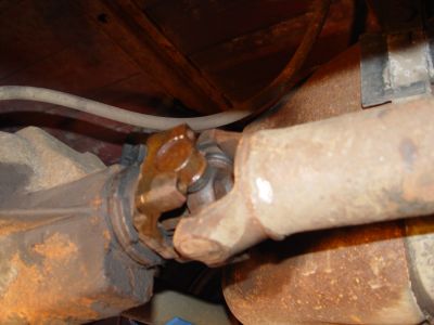

I'm at the back toward the rear-end of the truck and I've unbolted the caps on the U-Joint (differential end). The book says that I should just have to pull the drive shaft free but that is not happening.
I don't want to damage the bearing cap but I'm stuck right now. It appears it's just snug inside the area but I'm not sure.

Rogr that. Ihave everything loose and I have it on jacks.I'm following the book. It looks as if it should just pop out but this is a real bugger. The retaining clips have nothing to do with securing it in, right? It's just cover the cap and seal, correct?

Here a photo of what I'm up against...Thanxxx

Just put a pri bar or good strong screw driver behind the u-joint and pry on it. It will pop out. Then take electrical tape and tape the end up so the caps stay on it till you put it back in.

Thanxxx! I did just that this morning, figuring I'd just give it some muscle and I popped right out. I was intially afraid of damaging the part but all had turned out well.
Just now got done dropping the tranmission. After inspecting the transmission, I've got re-order the Clutch Fork as the replacement part is completely wrong. Looks like I'll be down at least a week as I'm writing to you from Heidelberg, Germany.
