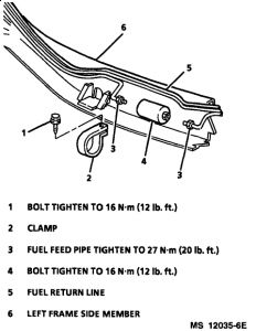

1995 Chevy S-10 6 cyl Two Wheel Drive Automatic
how to replace fuel filter

Advise fuel may be under pressure use a rag to cover lines when removing and have a drain pan ready.
