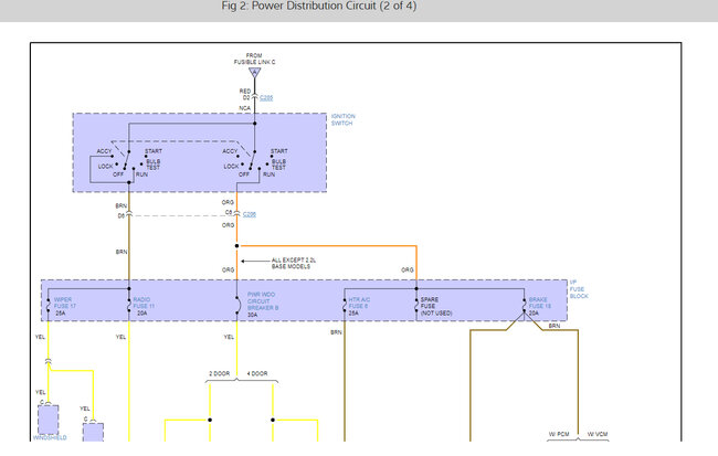

I am trying to hook up toggle switch to bypass ignition. I need to know how to do this. I am female but I was raised working around on trucks, but I have never had this problem. Can you help me?

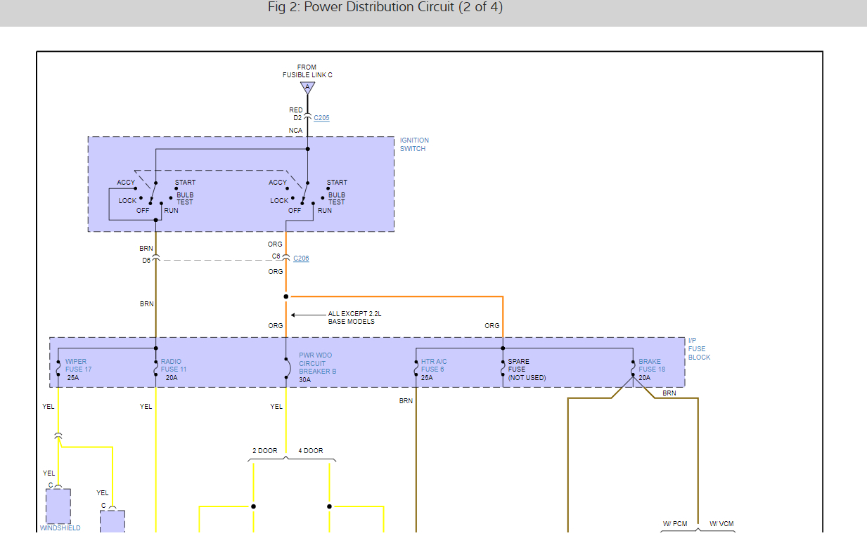

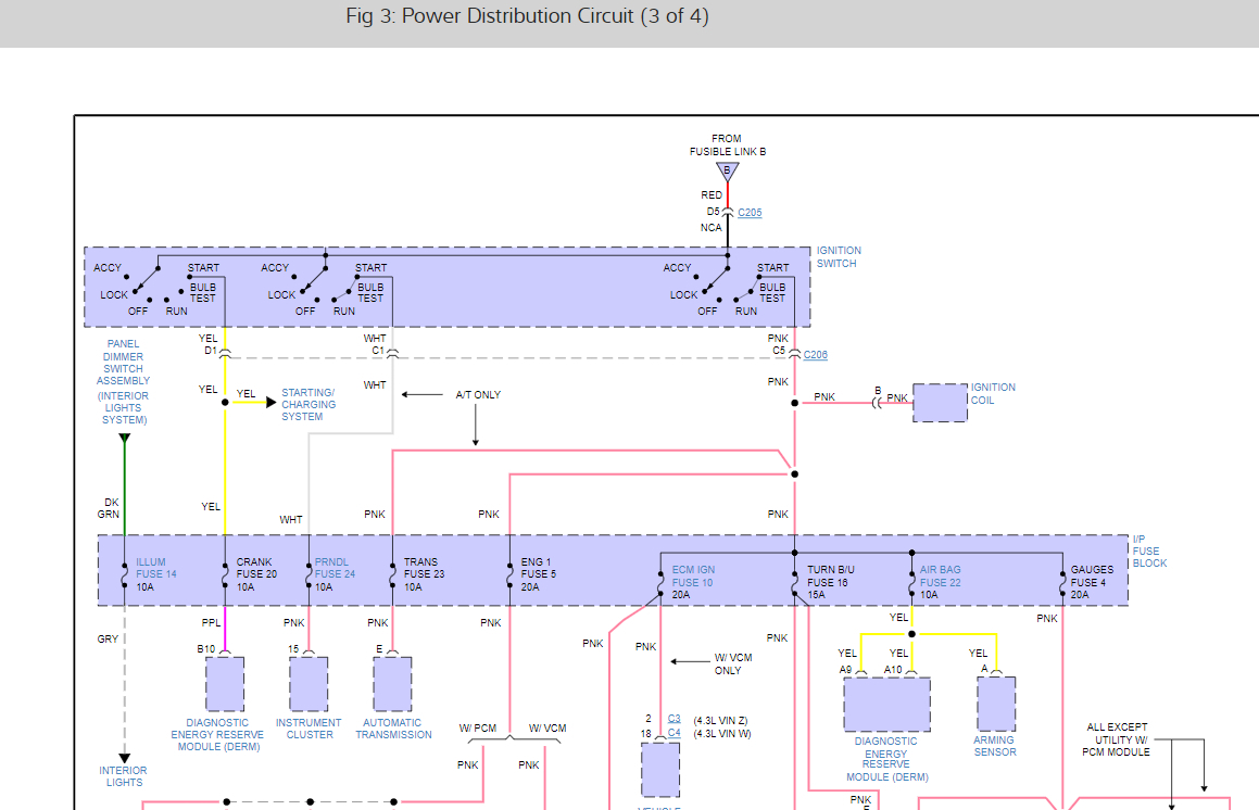

Here is the ignition switch wiring so you can see how to hook the switches up. Check out the images (Below). Please let us know if you need anything else to get the problem fixed.

If this truck has a security lite on the dash when you turn the key on you cannot go around it without reprograming the computer. You cannot change the key cylinder unless the dealer reprograms computer. The security system kills all elec. To fuel pump. Steve931 :wink:
