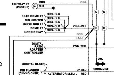

The old lighter in my truck was shot. I could not find a replacement so rigged a new complete lighter on the outside of the dash. Well the problem is that I keep blowing fuses. I used the old wires and connected them to new wires and connected to the new lighter. Everytime I push in the lighter a fuse blows. Any ideas?

Do you have the right size fuse? should be a 20 amp.
Check the wires at the fuse box for any corrosion or other problem at the panel.
https://www.2carpros.com/first_things/burned_fuse_connector.htm
Operate the other items on the circuit, do they work with out blowing it?

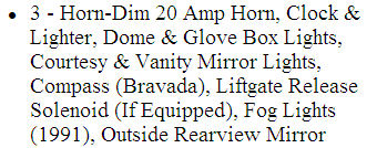

Unless mitchell one is wrong, there are other items on the circuit.
Check the wiring connections, including splices and the back of the fuse box.
If all good, return the lighter socket for a another.

Ok the horn and dimmer switch is on the same circuit. I have no glove box light. The only light on is the dome light. I don't even have instrument panel light and never have had those. I'm still blowing fuses. I used butt connectors to attatch the new wires to the old. I will keep looking.

2carprosJack adds:
Make sure the power is hooked to the center and ground to the body of the new lighter. Also need to be sure the old lighter is cut out of the circuit. Sounds like it may be hooked up wrong, goes to dead short when lighter is pushed in which connects the circuit
