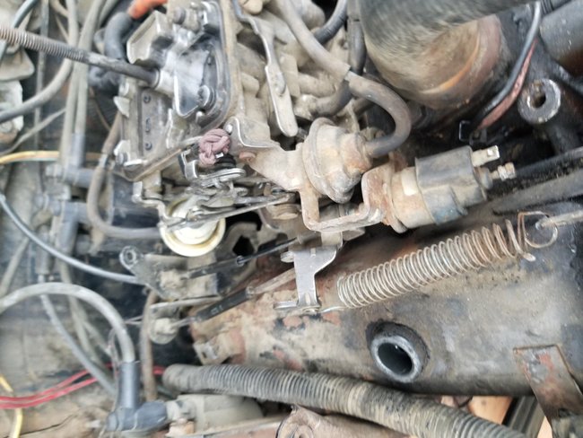

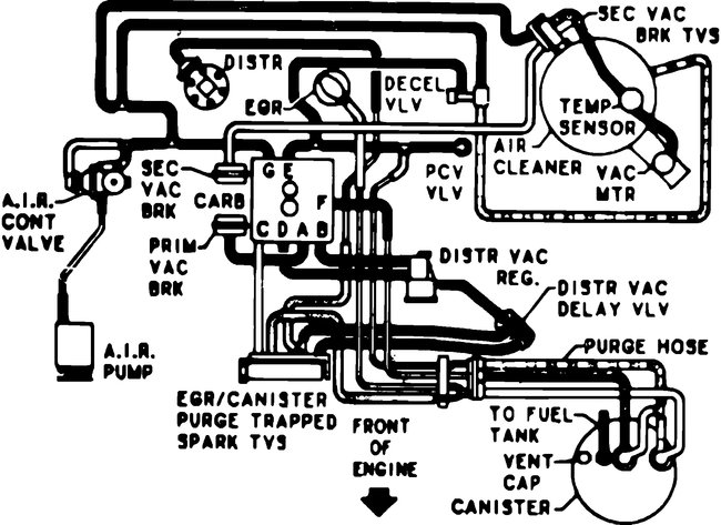

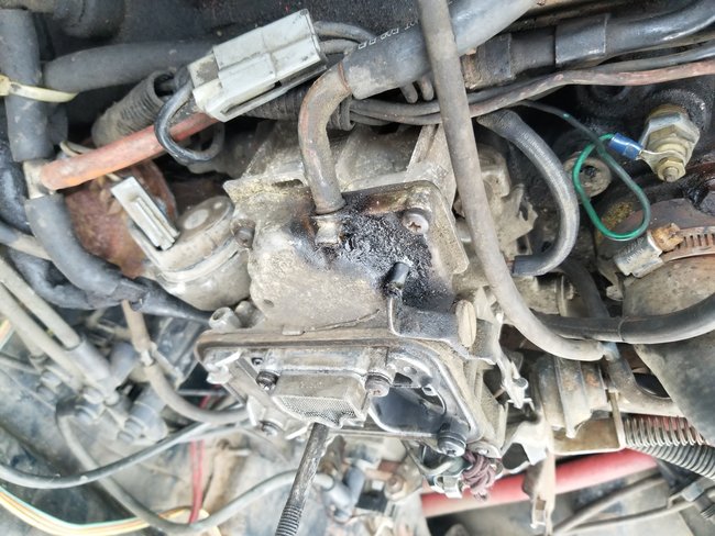

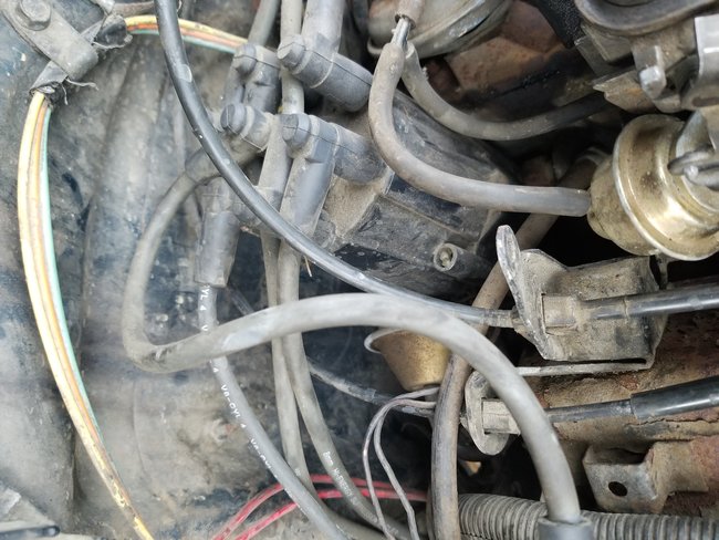

I let a friend look at my engine and he said a vacuum line was disconnected. It fixed the choke problem as it was a cold start in the mornings and the choke would never idle down. But when I get on the hwy and try to accelerate it's like I am letting off the gas and it will not over 30-40 mph and it surges causing it to jerk back and forth real bad. Sometimes when I let it cool down and drive it again it does not do it, but it seems to have gotten worse. I think this guy sabotaged my vehicle. I have had it for about 9 months and never had any problems until he messed with it. Please help me. Can you send me a diagram of vacuum lines in a 83 S10 Blazer 4wd 2.8 LTR engine 5 speed manual transmission? Thanks
Monday, December 14th, 2020 AT 9:36 AM (Merged)
  • 109,874 POSTS

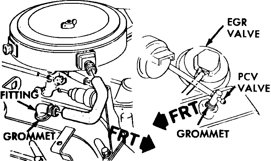

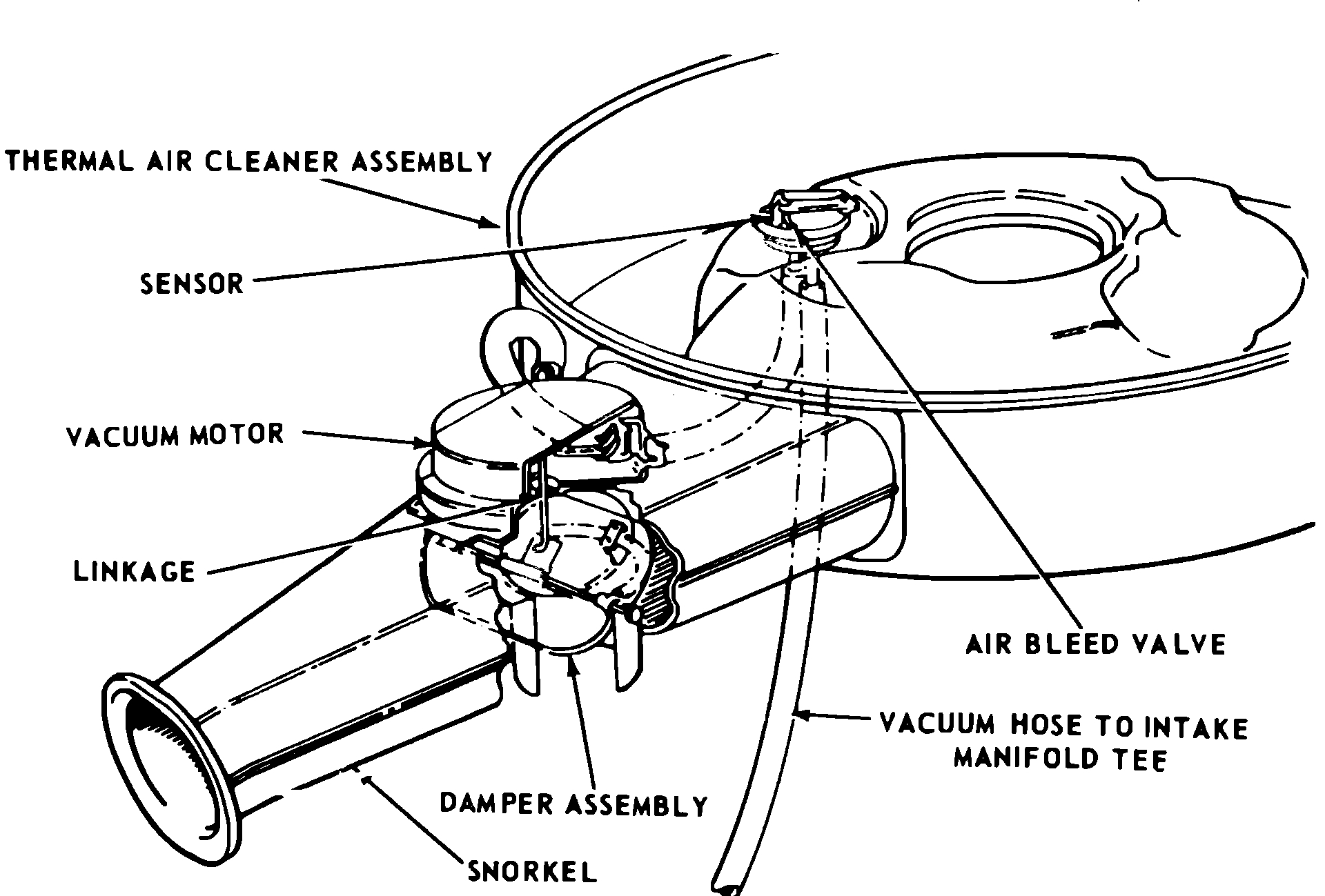

Welcome to 2CarPros.
I attached 3 pictures below of the vacuum system. They are for federal emissions. California is different, so if that is where you are located, let me know.

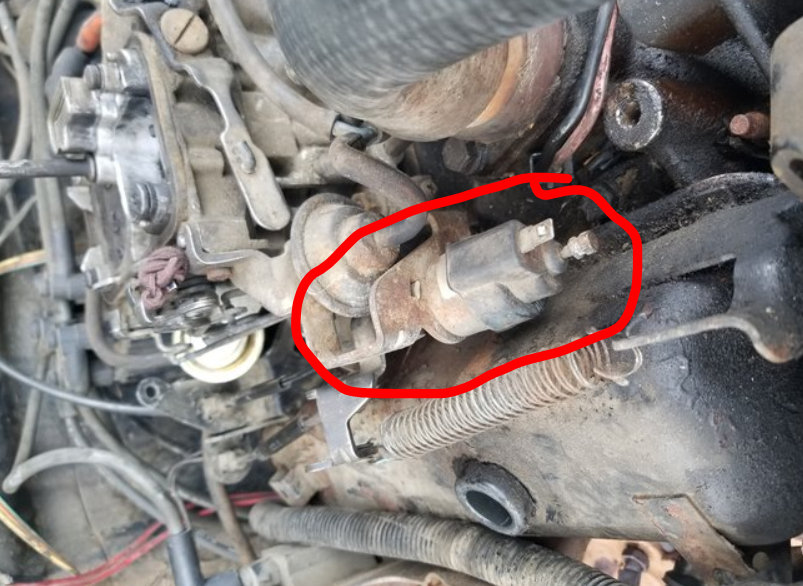

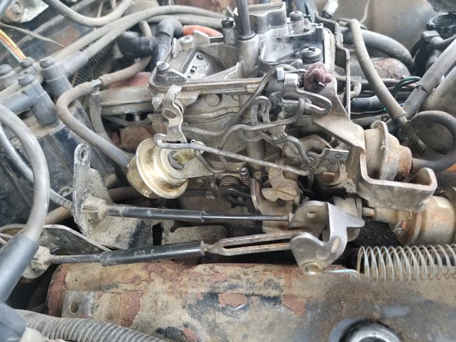

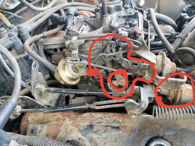

Now, when the engine is warm, remove the top of the air filter housing. Is the choke open or closed? Also, some of these had a vacuum pull off for the choke, I need to see yours to know if it does. If you can upload a pic of it, that would help me.
Last, confirm that the vacuum advance on the distributor isn't disconnected.
Let me know if any of this helps and what you find.

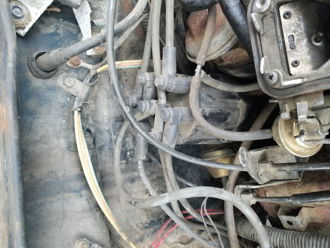

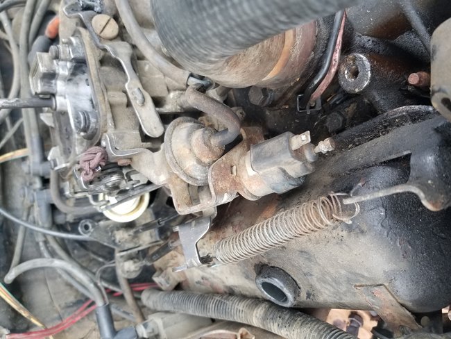

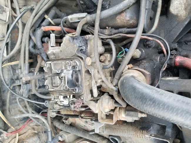

BKM97423
  • 49 POSTS
I don't know where any of that stuff your asking me about is, but I took some pictures fr you. I push on the gas and it just wont go. No power at all.
