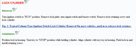

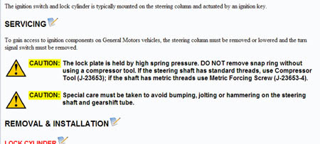

well see my ignition switch is broke so u have to start it with a flat head screwdriver and I recently bought a new switch a key and I dont know where to get the directions on how to replace it

http://www.2carpros.com/forum/automotive_pictures/62217_Lock_Cyla_1.jpg
http://www.2carpros.com/forum/automotive_pictures/62217_Lock_Cylb_1.jpg
http://www.2carpros.com/forum/automotive_pictures/62217_Lock_Cylc_1.jpg
