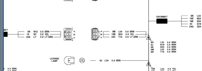

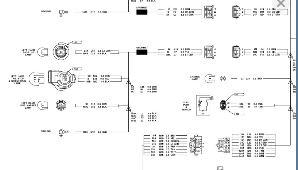

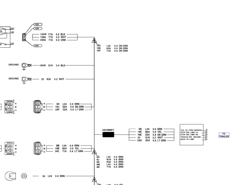

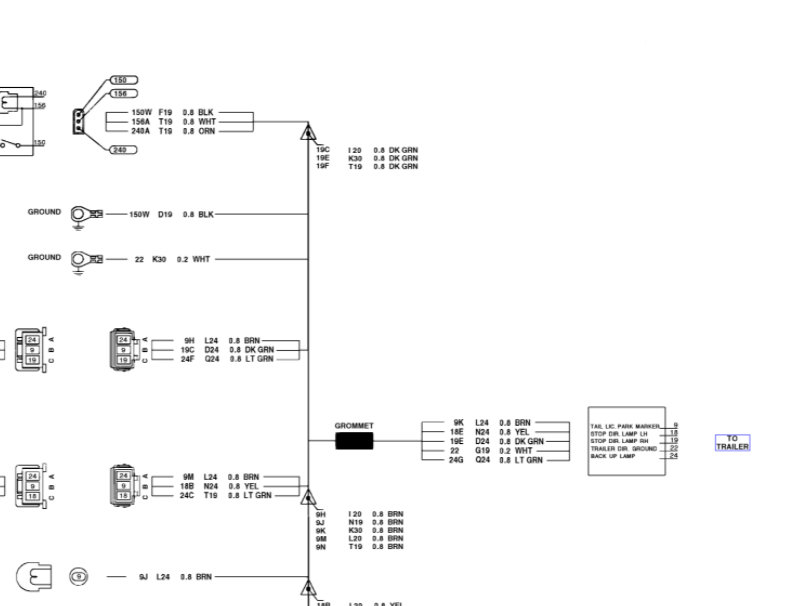

More than likely, we have a ground issue, but we need to start by running through this guide which will address some of these issues.
https://www.2carpros.com/articles/turn-signals-not-working-blinker
If the grounds are okay, then we need to jump to the switch and find out if the switch is sending voltage when the turn signals are on.
However, I am attaching the wiring diagrams below that will show the tail lamp and what pin we should be testing for voltage.
If you have voltage at the bulb with the brakes or turn signals on, then it can also be a socket issue.
Please run through the wiring diagrams below and let me know what you find.
