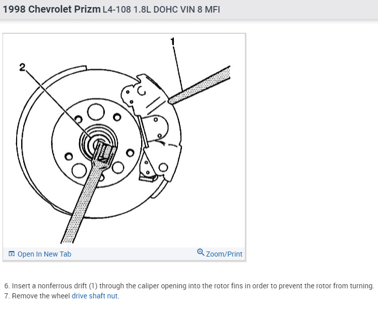

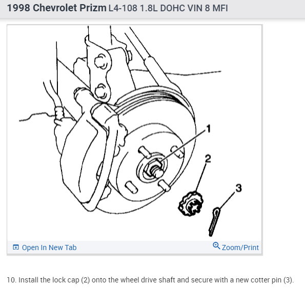

my 1998 prism has developed a "road noise" at highway speed. not tire noise same tires rotated and balanced. could this loud constant noise be from drive train or bearings ? where do i start to troubleshoot?

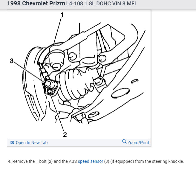

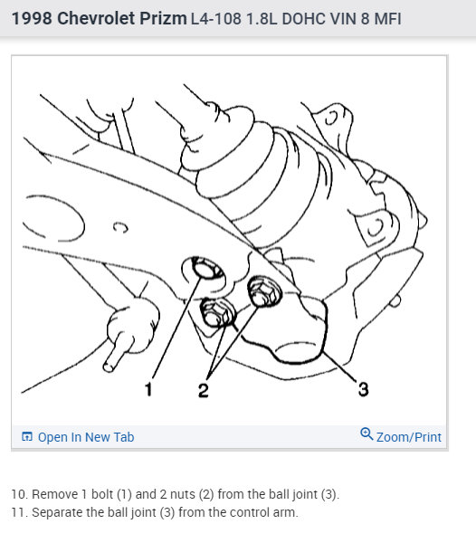

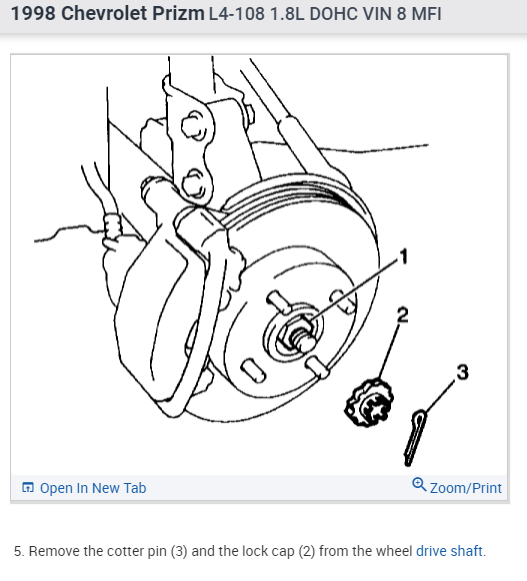

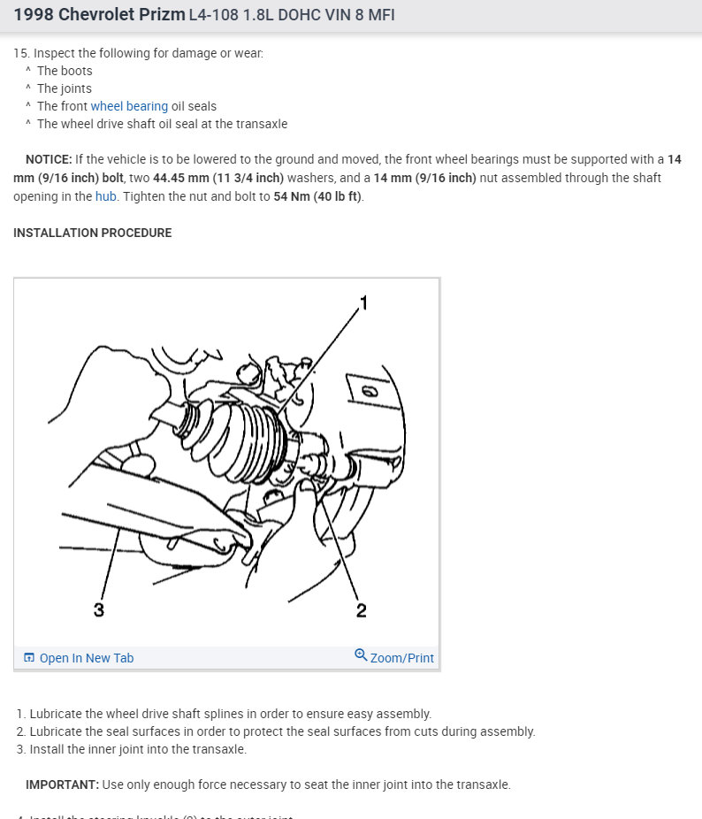

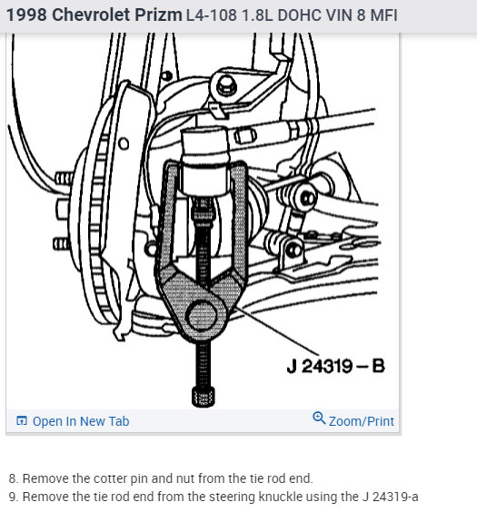

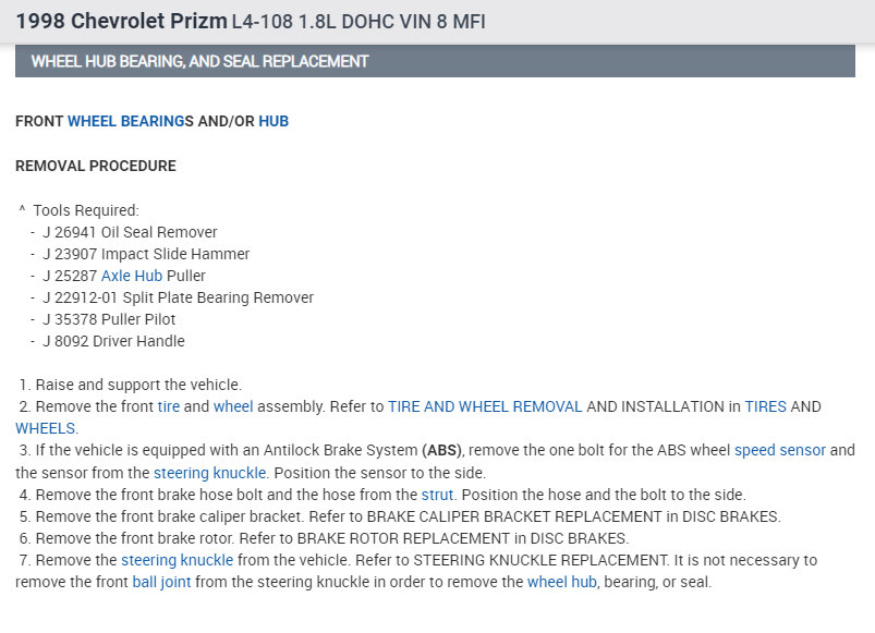

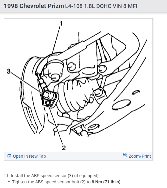

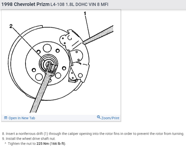

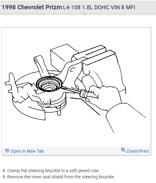

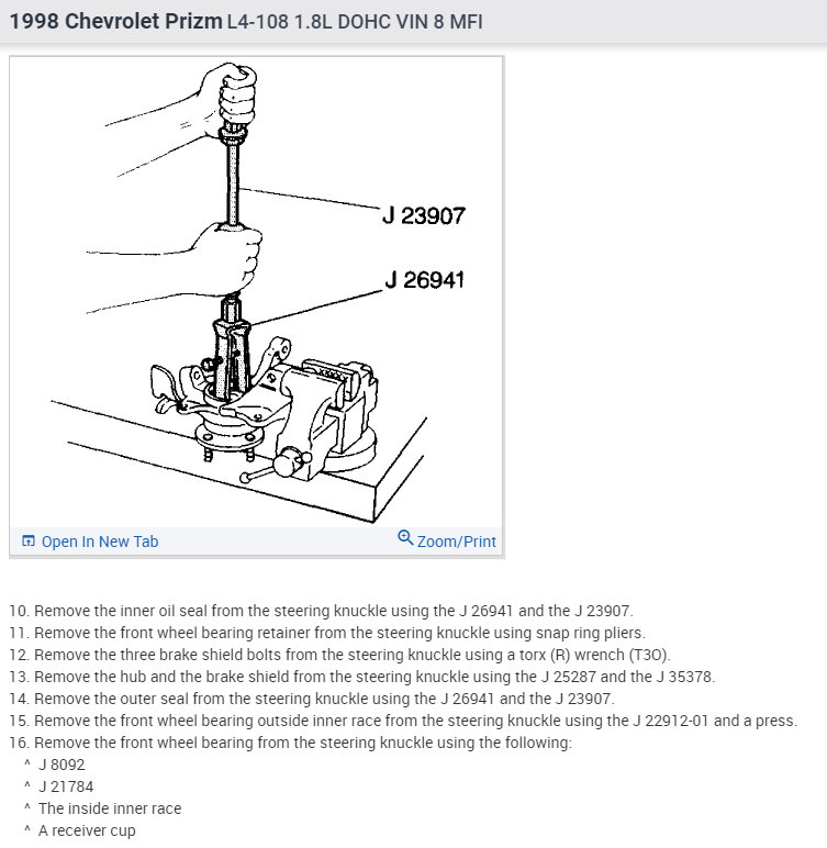

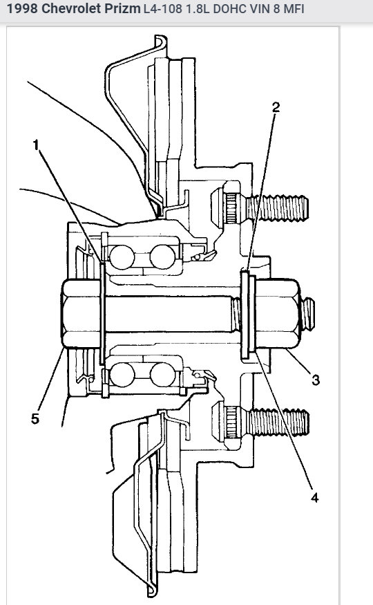

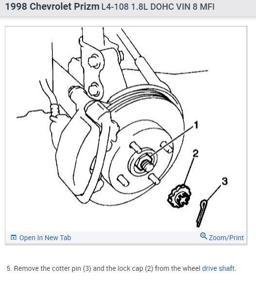

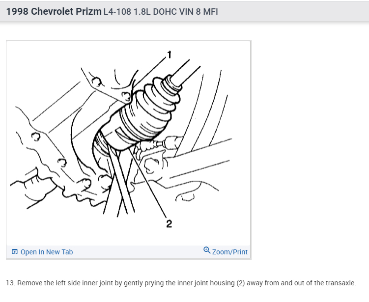

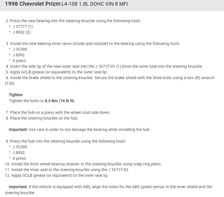

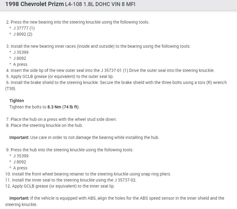

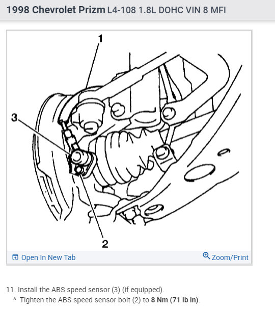

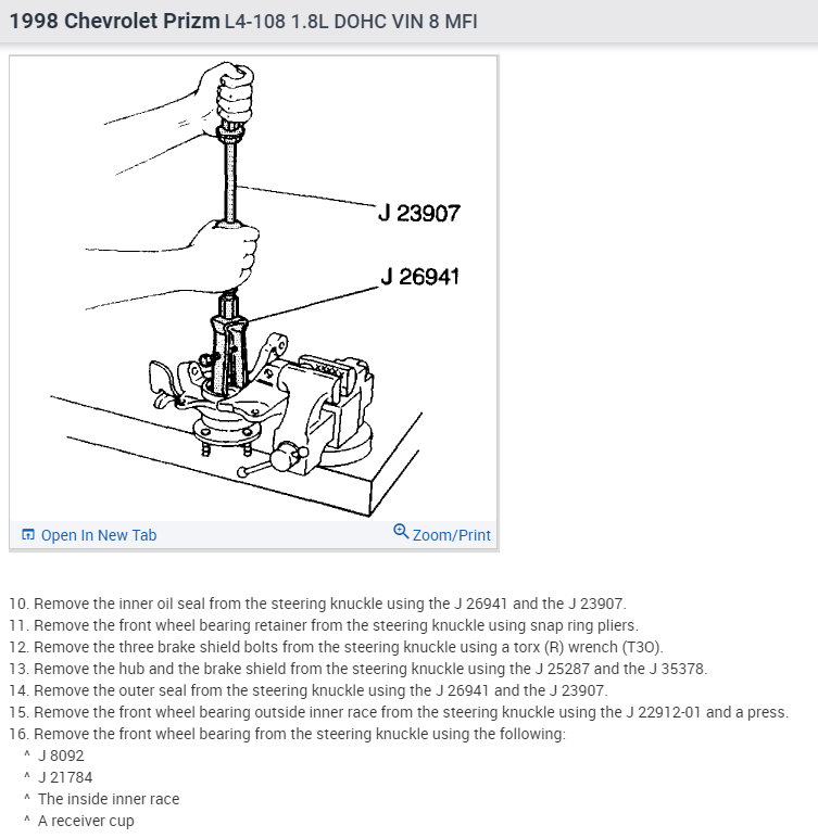

If the noise intensity increases with the speed, then it could be related to a bad wheel bearing.
It would be helpful if you could upload a video.
Can you tell if the noise is coming from one side or the other?

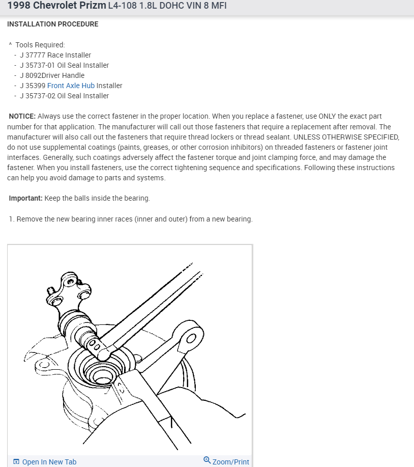

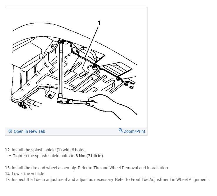

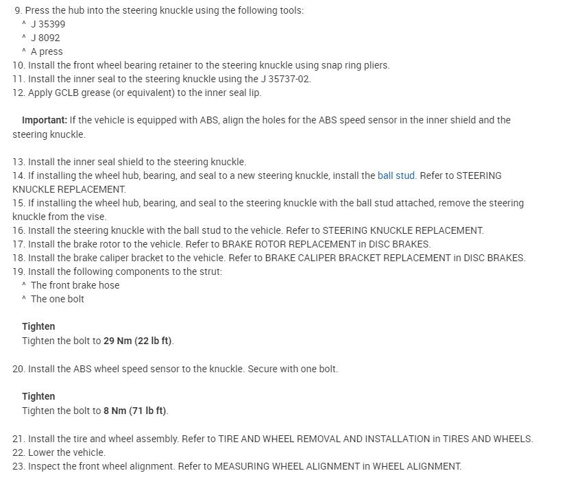

When the wheel bearing goes bad, it will make constant noise as you drive. And as the speed increases so does the noise.

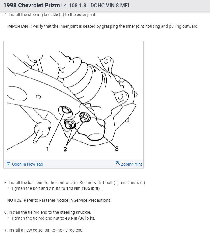

https://www.2carpros.com/articles/bearing-hub-replacement

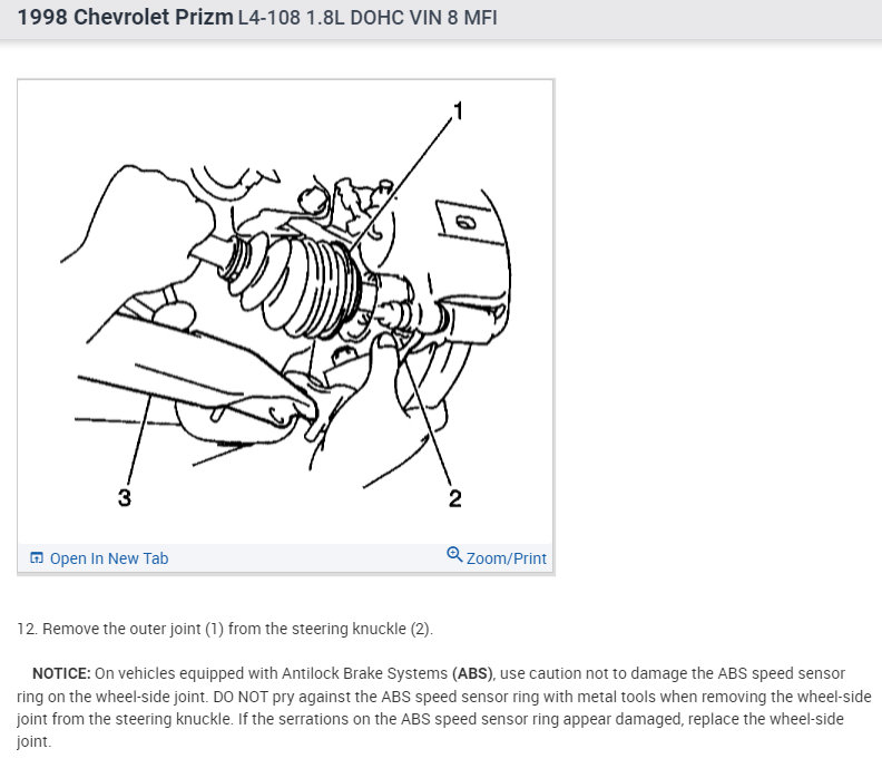

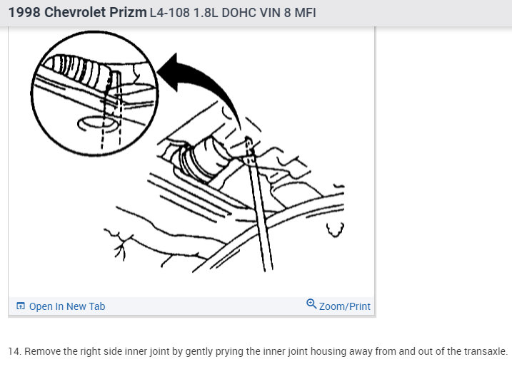

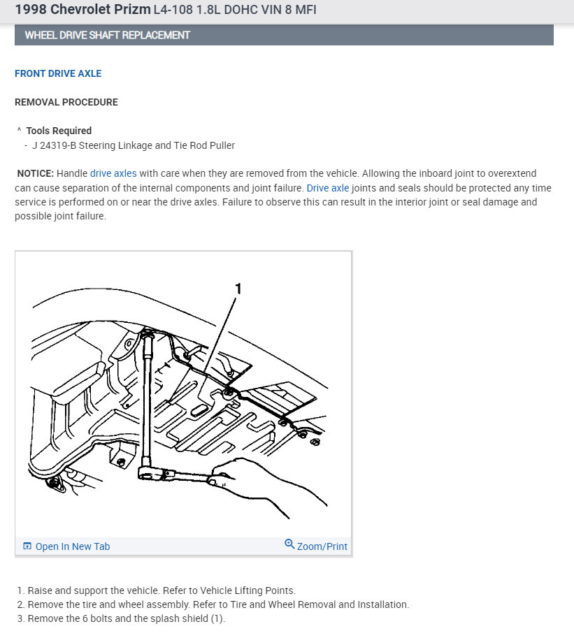

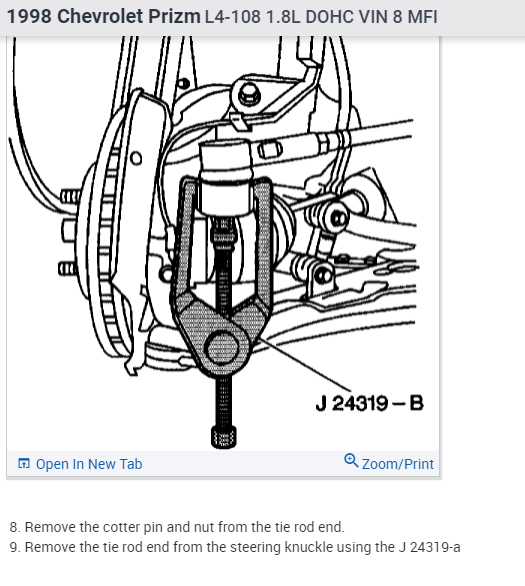

Does the noise increase or changes when you make a turn? If the CV axle is faulty, you will get clicking noise when turning.
https://www.2carpros.com/articles/clicking-sound
