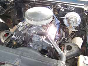

I own a 69 nova with a 71 el camino 350 engine and trans in it. The timing belt cover leaks a little bit what can i do about it?[img:8b98acc534]http://www.2carpros.com/forum/automotive_pictures/340140_3kf3ob3p7ZZZZZZZZZ942f5c6f050ed211021_1.jpg[/img:8b98acc534]

If I understand your question, you have replaced the timing chain with a belt drive?
Replace the timing cover, I prefer the cast aluminum covers as opposed to the stamped steel ones, which can distort badly when torqued.
Replace the crank seal also.
