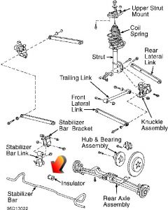

I keep hearing a sqeaking in my rear.I don't think its brakes, it does it w/o stopping. What could it possibly be?

There are a variety of possiblilities including a loose exhaust system or heat shield. The arrow points out a bushing that I have found to cause squeaks. The bracket can be loosened and a rubber shim installed to stop the noise.
https://www.2carpros.com/forum/automotive_pictures/30961_mc_1.jpg
Best bet is to have it put up in the air and have the technician jounce it while looking for the source. A particulat lift is required for this.
