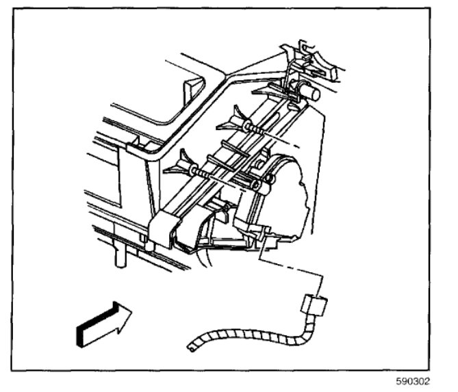

Heater not working
GEORGECOL
  • 2002 CHEVROLET MALIBU
  • 6 CYL
  • FWD
  • 82,000 MILES
I have anti freeze in the resiviour When the radiator fans come on the temp is normal but I have no heat in the car it blows cold air The engine does not over heat. Please please please help me
Friday, February 1st, 2008 AT 11:21 PM
18 Replies
KEN L
  • MASTER CERTIFIED MECHANIC
  • 48,579 POSTS

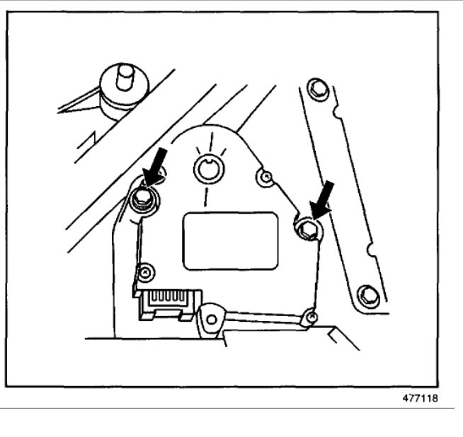

It sounds like you have a temperature blend door actuator that has gone out. Here is a guide and a diagram (below) to help you get the car fixed.
This guide may help as well
