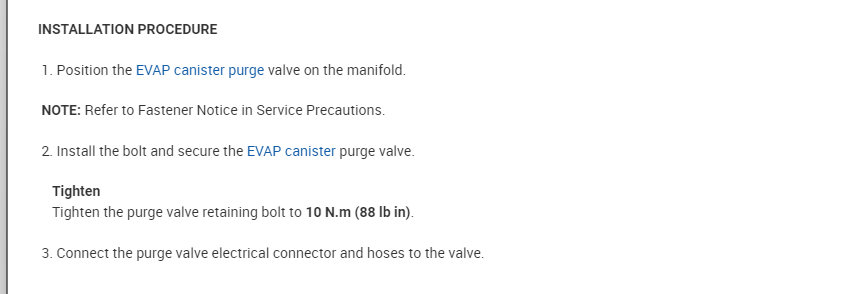

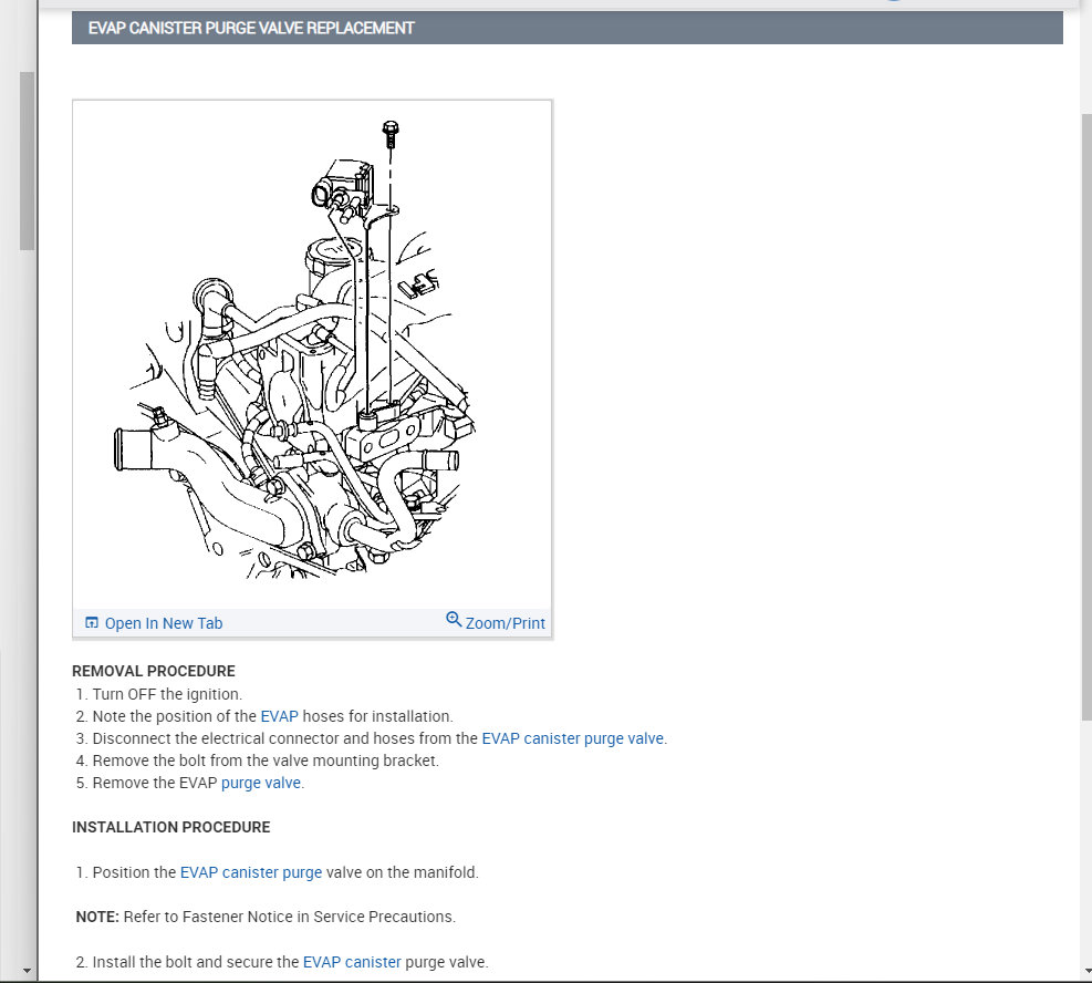

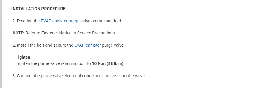

I am attaching the info from the manual on replacing this which is what I would do.
Basically, when you remove it, check to see if there is any chalk looking substance inside of it. If there is then you more than likely have raw fuel in the charcoal canister which breaks the charcoal down.
Please let us know what questions you have. Thanks
