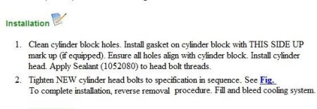

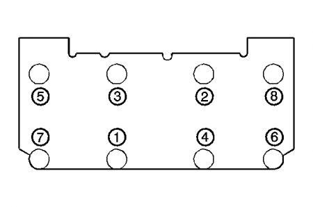

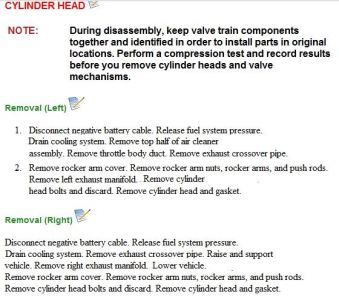

1999 Chevy Malibu Change head gasket
ORGANIZER
MEMBER
1999 CHEVROLET MALIBU
6 CYL
FWD
AUTOMATIC
101,000 MILES
Procedure for changing head gasket.
Wednesday, May 26th, 2010 AT 11:11 AM
BLUELIGHTNIN6
MECHANIC
16,542 POSTS
SPONSORED LINKS
+2
Wednesday, May 26th, 2010 AT 4:41 PM
