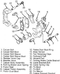

i am having a hard time tryin to figure out how to get off the rear drivers side brake caliper, for a 1998 chevy lumina ltz 3.8 liter all disc brakes can someone tell me how to get it off? the caliper has a pivot action, so when u need to change the brake pads all u have to do is take one bolt off and pivot the caliper up, and replace the pads, how do i get the pivot part to be able to come out easily so i can replace caliper.?

If I was doing this job on this particular body style, I would replace the calipers, pads and rotors. Does this drawing help?
https://images.2carpros.com/forum/automotive_pictures/30961_lumbrk_1.jpg

yes it does help alot thank you!!! but how do i get number 21 the PIN BOLT out? and i already bought the rotor and brake pads as well as the caliper, just having a hard time trying to figure out how to get that pin bolt out.

The caliper slides off of #22, the pin sleeve, the pind doesn't come out. It is a pivot point . Depending on the caliper you bought, it may be more evident by looking at it.

ok thank you very much!
