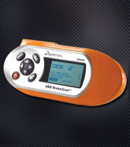

Before we go any further, please post the actual code NUMBERS from Autozone for proper diagnostic. Their scanner only reads the check engine light, not the ABS. ABS system requires a scanner capable of ABS system, such as this one,
https://images.2carpros.com/forum/automotive_pictures/55316_cp9449_3.jpg
Autozone dos not have this scanner, but most repair shop will have similar units.
