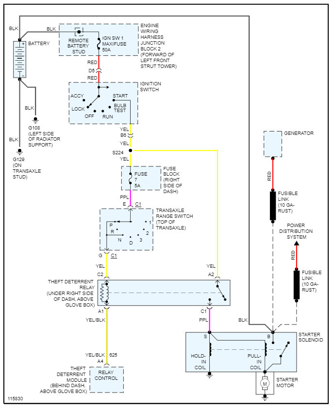

When I turn the key to turn the car on, everything in the car and the head lights turn on but the engine won't. I just replaced the starter and it still won't start. When I turn the key the "Security" light pops up. What does this mean and what do I do next?

How to bypass the VATS (PASSKey II) system in a late model GM vehicle

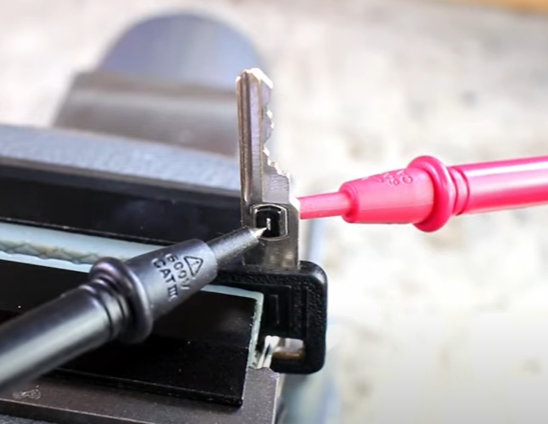

1. Take your DMM, set it to measure Ohms (use the 20k setting.) Measure the resistance across the pellet of the ignition key. Place one probe on the silver part of one side of the pellet, and the other probe on the other side. Write this value down.

6. Measure the resistance across the 2 wires now that the resistors are soldered to them. Be absolutely sure the value matches that of the resistor pellet in the ignition key (within 2% up or down.)

15. Attempt to start the car. If your problem was with the VATS reader in the ignition lock cylinder, this will start the car.
If this won't start the car, then the problem is in the VATS module. If the VATS module is bad, remove the resistor pack. Strip the insulation off the other side of the main wire cut (running from the column) and place a male connector on one wire and a female on the other. Plug the 2 halves back together to restore the function of the VATS reader.
