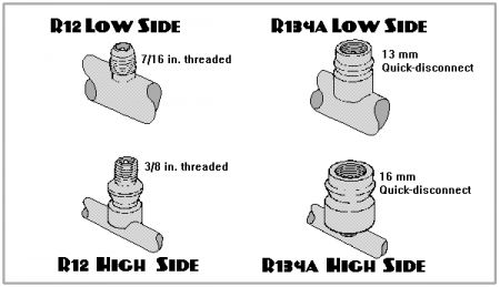

HOW CAN I ADD FERION TO THE A/C WHERE THE IN PUT
Saturday, May 15th, 2010 AT 6:06 PM
MECHANIC
75,992 POSTS
Look for the 13mm fitting its in between the compressor and the evaporator
