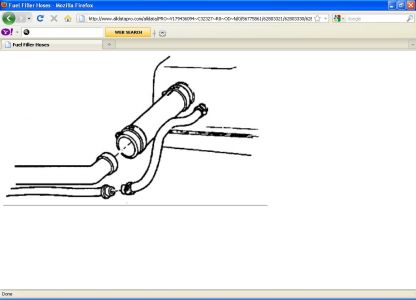

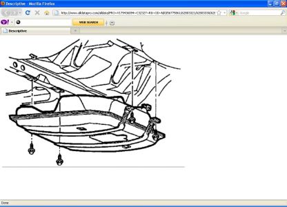

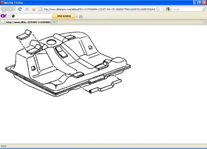

Can u please explain how to replace gastank or take it out to see if I can seal it myself or it has to be replaced all together

REMOVAL PROCEDURE
1. Relieve the fuel system fuel pressure. Refer to Fuel Pressure Release.
2. Drain the fuel tank.
3. Raise the vehicle.
4. Remove the fuel tank filler EVAP hose from the fuel tank.
5. Remove the fuel tank filler hose from the fuel tank.
6. Remove the quick-connect fittings at the fuel tank.
7. Remove the modular fuel sender, and the fuel tank pressure sensor electrical connectors.
8. Remove the EVAP pipe from the connection at the front of the fuel tank.
9. Remove the rubber exhaust pipe hangers in order to allow the exhaust system to drop slightly.
10. Remove the exhaust pipe heat shield bolts and the exhaust pipe heat shield.
11. With the aid of an assistant, support the fuel tank, and remove the fuel tank strap attaching bolts which retain the fuel tank straps.
12. Lower the fuel tank enough in order to disconnect the fuel sender electrical connector and remove the fuel sender retaining clips.
13. Remove the EVAP pipe to the rear of the fuel tank.
14. Remove the EVAP pipe to the fuel sender assembly.
15. Remove the fuel tank from the vehicle and place the fuel tank in a suitable work area.
16. If the fuel tank is not being replaced, go to Installation Procedure.
17. Remove the modular fuel sender assembly.
18. Remove the retaining clip from the EVAP pipe. Note the position of the retaining clip for installation.
19. Remove the EVAP pipe from the insulator clips. Note the position of the EVAP pipe for installation.
20. Remove the quick-connect fittings at the fuel sender.
21. Remove the fuel feed and fuel return pipe assemblies and the insulator clips from the fuel tank.
22. Remove the insulator pads from the fuel tank. Note the location of the insulator pads for installation.
