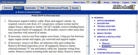

How do I change the starter on my lumina. Everything I've read gives conflicting information. If you could explain and show diagrams Thank you

Take the 2 15 mm bolts out and the other 2 on the selanoid and wiggle it out

Hi steveschorn and TY for the donation
See starter removal below I'm sorry unable to provide step by step pictures on removal
