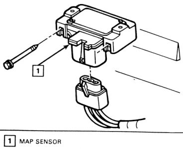

MATHIASO
  • 1,209 POSTS
Hello jetcatjohn
MAP sensors monitor changes in intake vacuum, which is a way of determining engine load. When engine load goes up, intake vacuum drops. Vacuum is highest at idle and drops during acceleration and wide open throttle.
The computer uses the MAP sensor's input to vary ignition timing and the fuel mixture. So a MAP sensor problem may cause drivability problems such as surging, poor fuel economy and performance.
It is located under hood, center, upper engine area, above rear valve cover, mounted in bracket
https://www.2carpros.com/forum/automotive_pictures/46384_0900c15280067e2e_1.jpg
Auto part, auto zone and O'Reilly offer free scanning.
As I explained for the fuel trim(print it if you like), you can read it directly from the scanner.
start with fuel filter, lot of build up of rust in the fuel filter could cause the problem too, specially the 150000 miles.

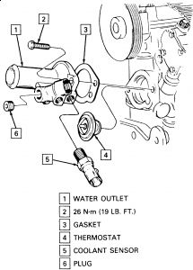

Hello jetcatjohn
A lazy coolant sensor may cause the problem.it should change resistance as the coolant temperature increases and decreases.
# Remove the temperature sender from the engine.
# Position the water temperature sending unit in such a way that the metal shaft (opposite end from the electrical connectors) is situated in a pot of water. Make sure that the electrical connector is not submerged and that only the tip of the sending unit's body is in the water.
# Heat the pot of water at a medium rate. While the water is warming, continue to measure the resistance of the terminal and the metal body of the sending unit:
# As the water warms up, the resistance exhibited by the ohmmeter goes down in a steady manner: the sending unit is good.
# As the water warms up, the resistance does not change or changes in erratic jumps: the sender is bad, replace it with a new one.
https://www.2carpros.com/forum/automotive_pictures/46384_coolant_1.jpg
Friday, April 16th, 2010 AT 7:51 AM

Resistance changed and the unit seems to work as advertised. Don't think it is the problem.
Any other ideas?
