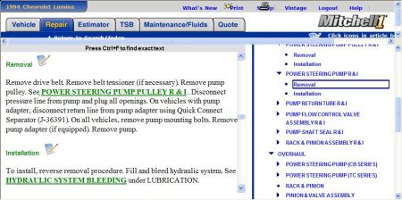

i am a new driver of a chevy car i am not used to chevy i think the power steering is bad i put a bottle of power stearing fluid in the resavor the next day i have to do it a gain i plain to fix the probulm but i dont have a book to do it is there plains to copy free
Sep 25, 2009 at 9:38 AM
  • 75,992 POSTS
See below Removal

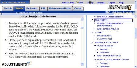

Bleeding it
