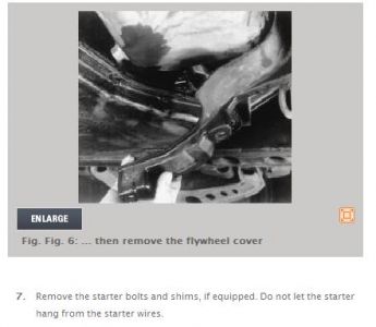

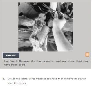

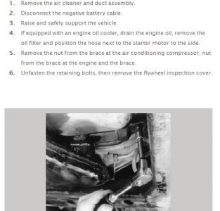

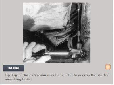

How to replace the starter on 1993 Lumina 3.1 Liter Engine

Welcome to the forum, the info below came from autozone.
