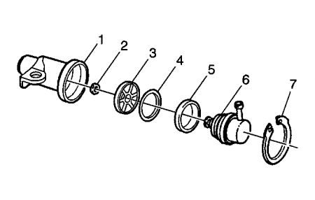

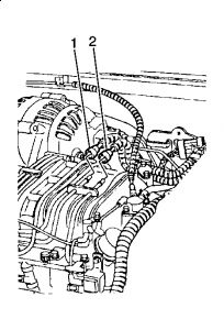

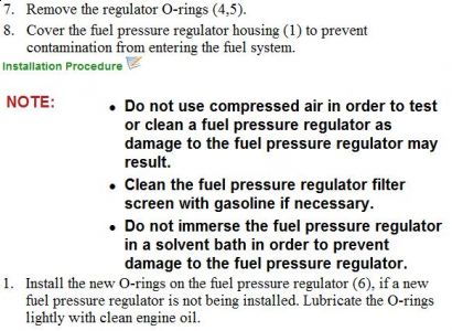

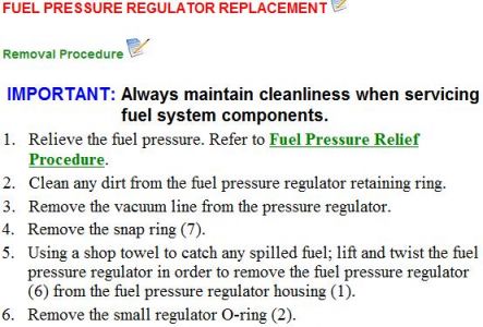

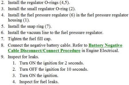

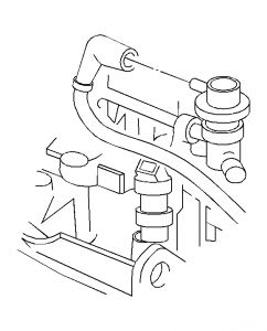

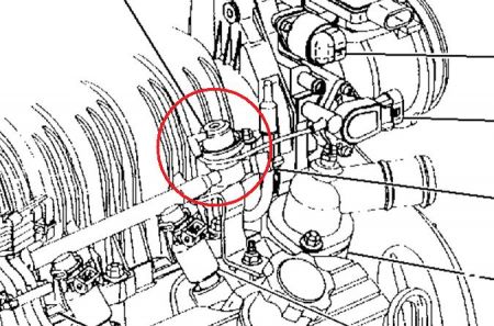

I am just trying to get some instructions on how to change out the fuel pressure regulator. It is visible but other parts are crowding it so I want to make sure of the best way to change it out. Can you help me out?

https://images.2carpros.com/forum/automotive_pictures/55316_05impalapressreg1_1.jpg
https://images.2carpros.com/forum/automotive_pictures/55316_05impalapressreg2_1.jpg
https://images.2carpros.com/forum/automotive_pictures/55316_05impalapressreg201_1.jpg
https://images.2carpros.com/forum/automotive_pictures/55316_05impalapressreg202_1.jpg
https://images.2carpros.com/forum/automotive_pictures/55316_05impalapressreg3_1.jpg
https://images.2carpros.com/forum/automotive_pictures/55316_05impalapressreg4_1.jpg
https://images.2carpros.com/forum/automotive_pictures/55316_05impalapressreg203_1.jpg
10. Install fuel injector sight shield
