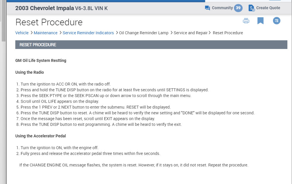

i just got my 03 impala. its a 3.4l v-6 and i already did a tune up..changed motor oil, oil filter,transmission fluid, air filter, plugs, wires, new battery and all of that but i cant figure out how to reset the "change engine oil" light on dash. if any one has the answer i would really appreciate the help because that light really buggs me.. i hate seeing those lights on my dash..

No problem. There are two ways to reset the light on this generation of vehicle.
I am attaching the info from the manual below but here is a guide that will help on most vehicles:
https://www.2carpros.com/articles/oil-life-reset
Please see the info attached below which is using the radio or the accelerator pedal.
Let us know if you have other questions.
