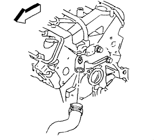

Flushed radiator and added dexcool coolant. Bought a thermostat to try and replace it thinking it can be the problem but cant find the thermostat on the car. Also the car is smoking oout of or around the air filter. What can this be?
Tuesday, October 19th, 2010 AT 11:27 AM
  • 75,992 POSTS
Thermostat location-see below for he smoke check and test the PCV system
https://www.2carpros.com/forum/automotive_pictures/12900_stat_8.gif
