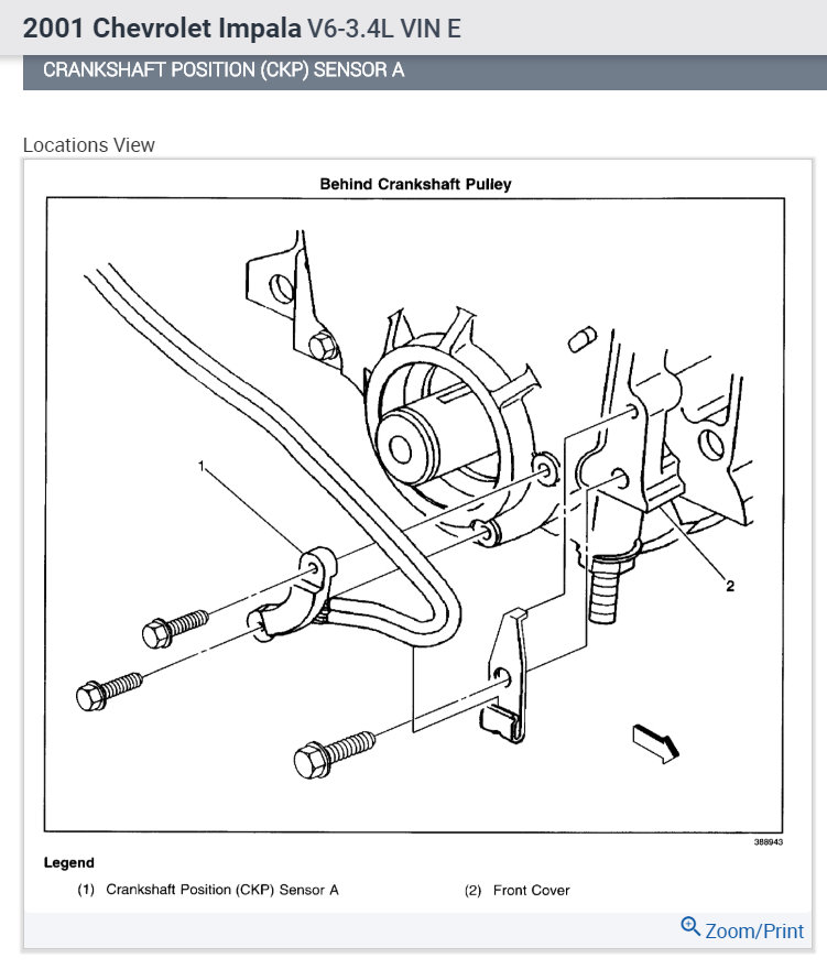

Car will not stay started. Only stays running if I am holding down the gas pedal. I change fuel pump/fuel filter/spark plugs/wires and plugs/fuel injectors/battery/alternator.
Aug 25, 2018 at 5:33 AM
  • 55,673 POSTS
These cars had a big problem with the crankshaft angle sensor which go out all the time. We should run the codes though. Here are two guides that will help get started and the location of the sensor:
and
