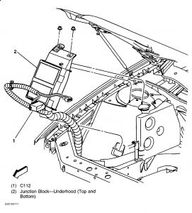

Hi the fan in towards the front (headlights) is blowing while the engine is off and I was told that I need a new motor for it I was wondering if I could get just the motor or do I have to buy the whole kit? Also I was wondering what the name is of the motor?

Most likely fan relay stuck in on position. see diagrams locate underhood junction box
https://www.2carpros.com/forum/automotive_pictures/198357_Graphic_353.jpg
in the bottom side you will fine two fan relays pull out see if fan stops
https://www.2carpros.com/forum/automotive_pictures/198357_Grafic_3_95.jpg
if yes then replace relay
