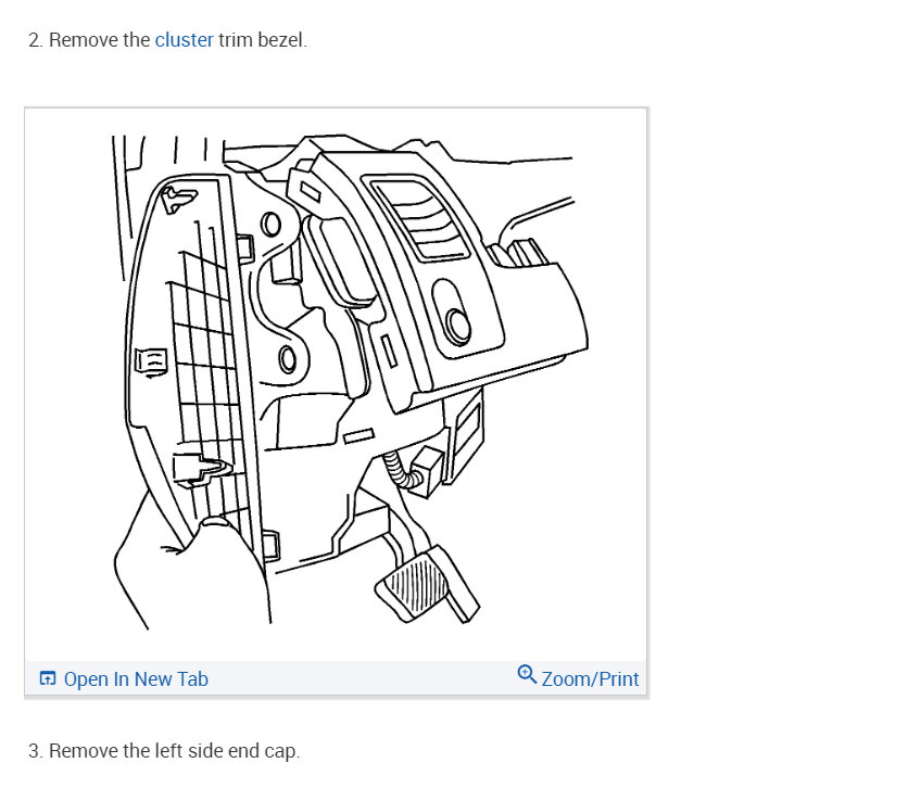

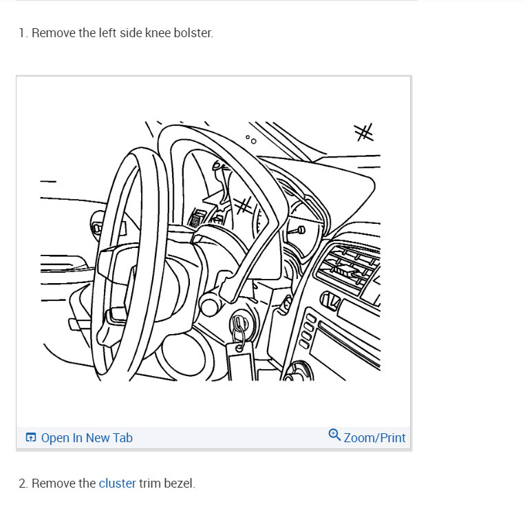

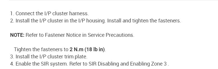

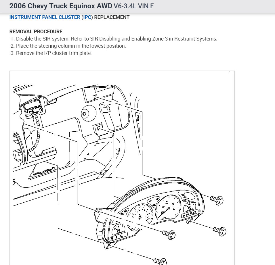

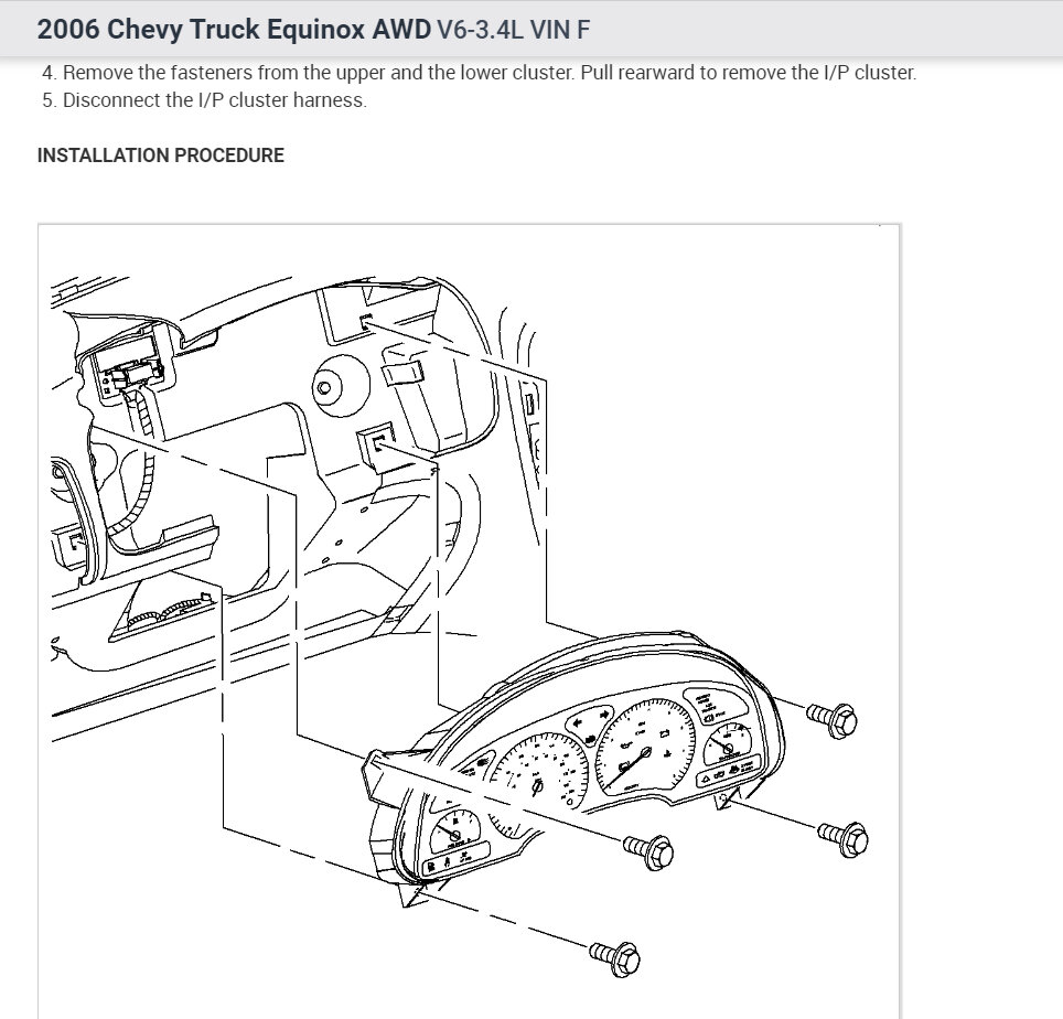

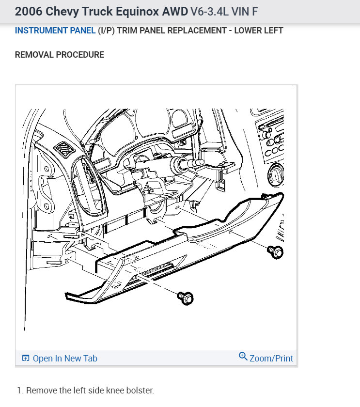

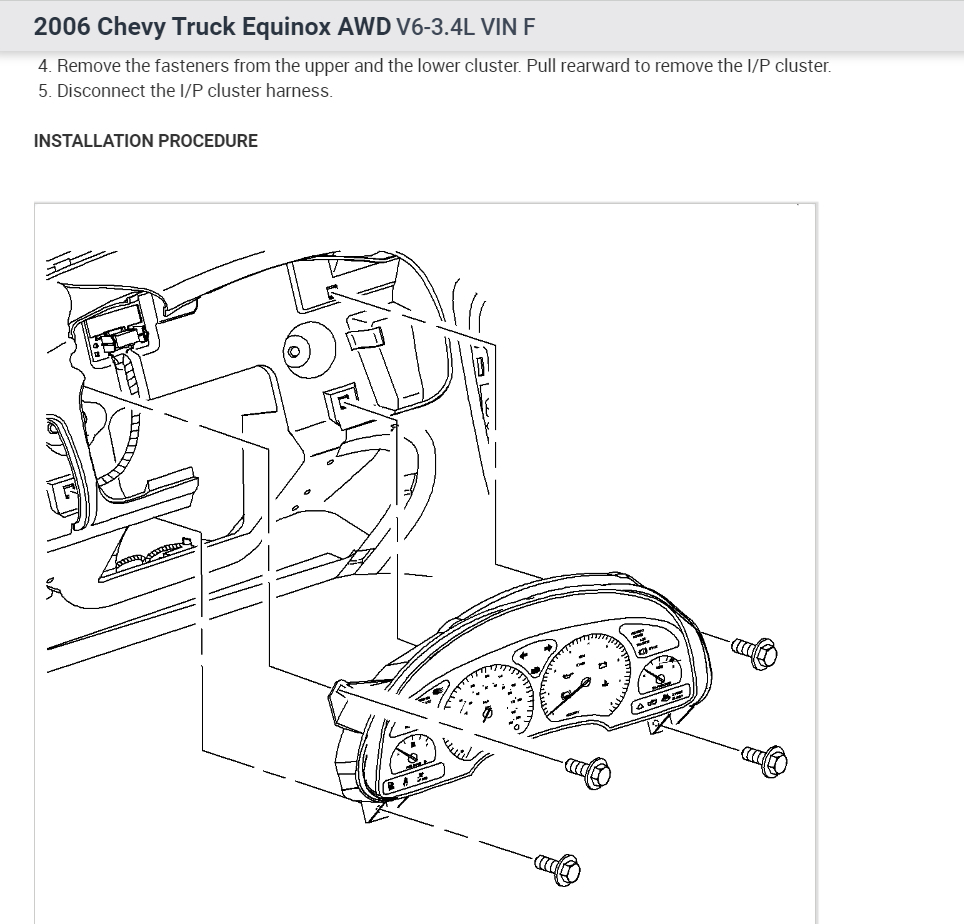

how do i remove the dash cluster i have a light bulb burnt out on the tach side of the gauges?
Jul 27, 2010 at 11:26 AM
SATURNTECH9
  • 30,869 POSTS
Here is how to change out the the instrument clusters so you can replace the bulbs. Check out the images (Below). Please let us know if you need anything else to get the problem fixed.
