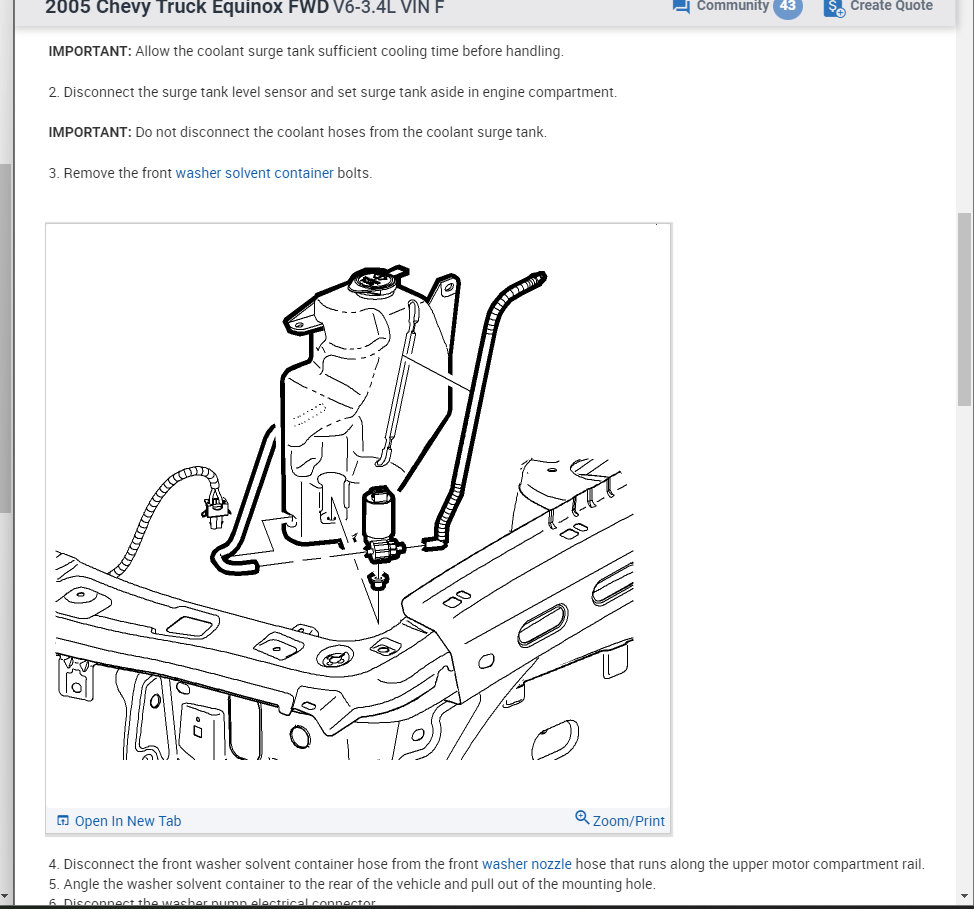

Where is the windshield washer pump located so it can be replaced?

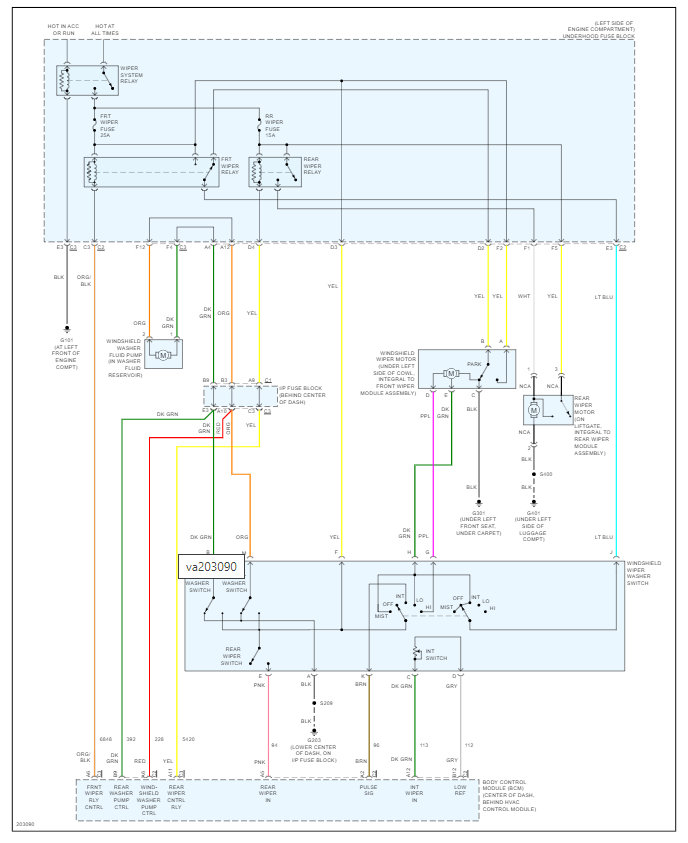

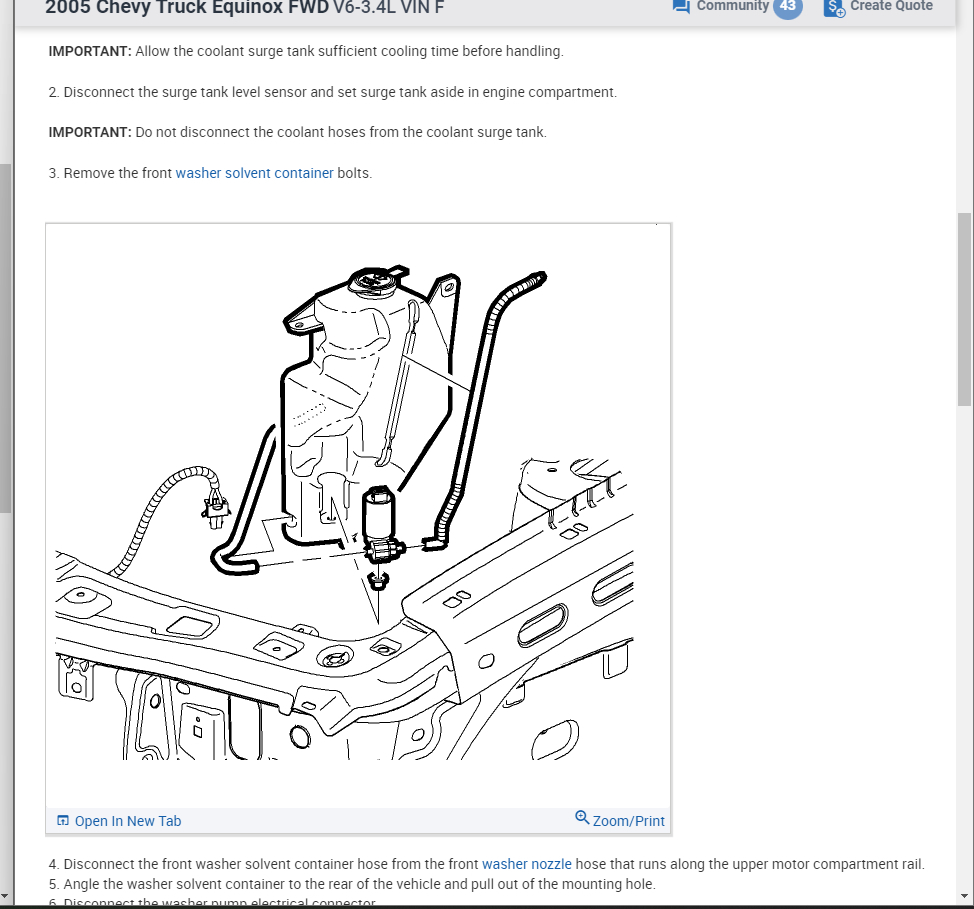

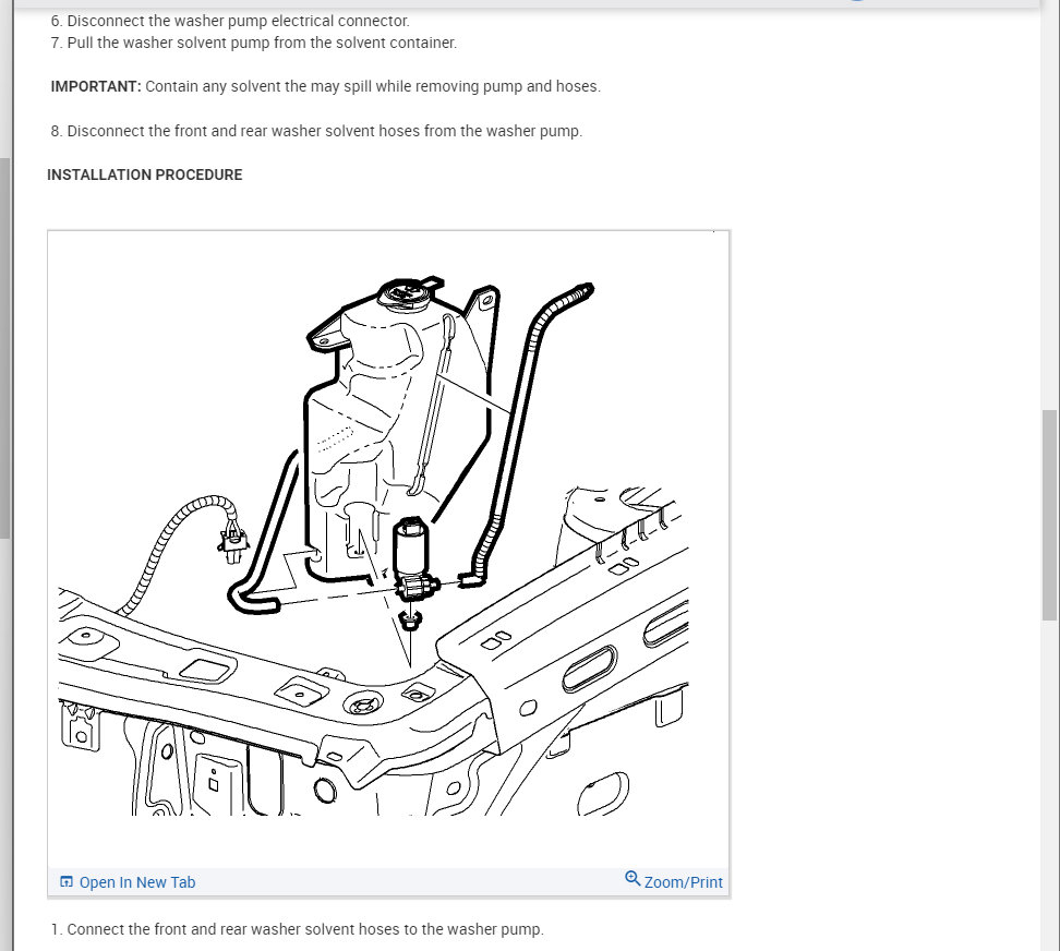

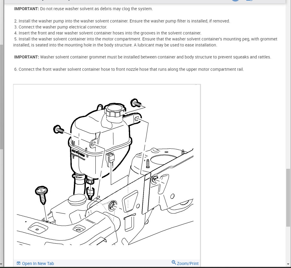

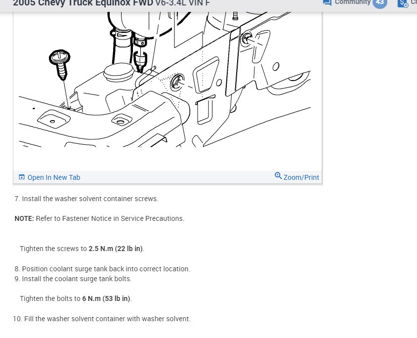

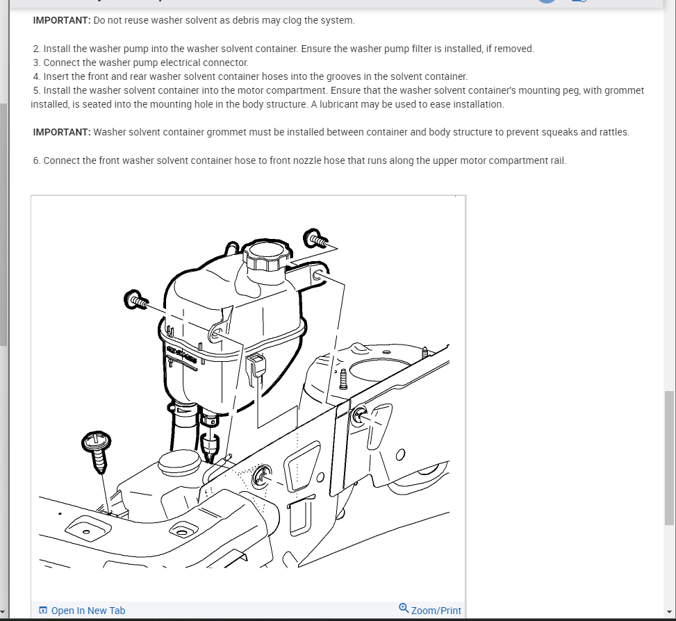

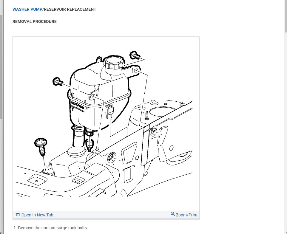

I am attaching the info needed to determine where this is and how to replace it.
However, here is a guide that will give a little more detail on this:
https://www.2carpros.com/articles/how-to-replace-a-windshield-washer-pump
Please run through this info and let me know if you have other questions or issues in replacing this.
