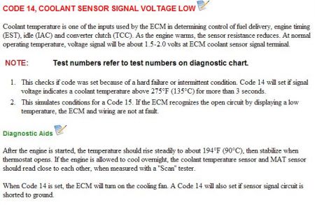

running poorly when got a code of 14 any clue what that code is
Thursday, June 11th, 2009 AT 8:09 PM
BLUELIGHTNIN6
MECHANIC
16,542 POSTS
Code 14 : CTS Signal Voltage Low
More details about this code are below..
