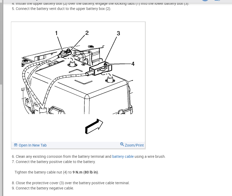

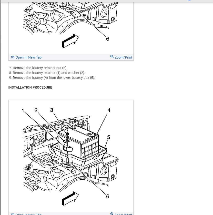

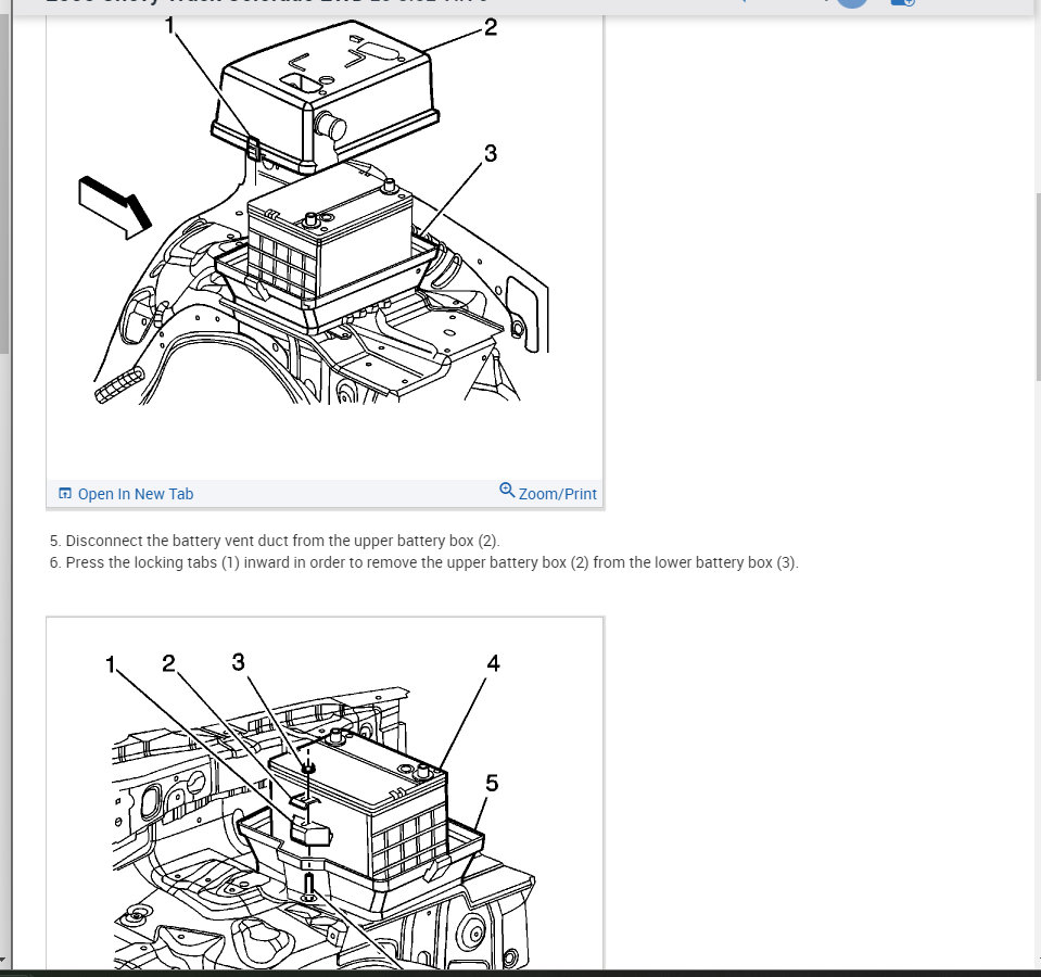

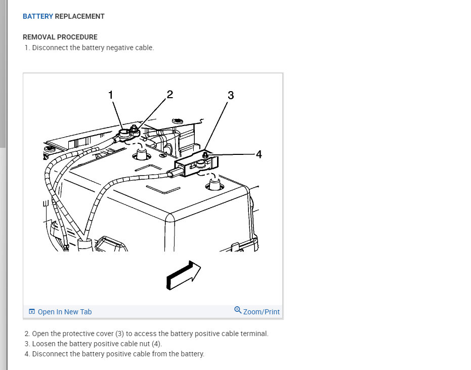

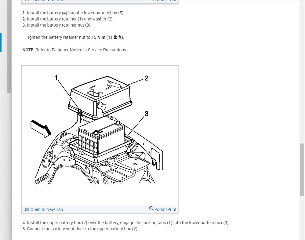

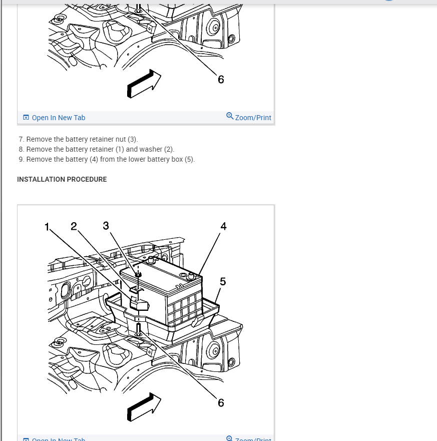

How do i change the battery in my truck?
Jul 29, 2010 at 7:35 AM
Here is a guide that will help with doing this in case you need a little more detail than what is in the manual:
https://www.2carpros.com/articles/how-to-replace-a-car-battery
However, below you will find the steps from the manual that will help with getting this complete.
Please run through this material and let me know if you have other questions. Thanks
