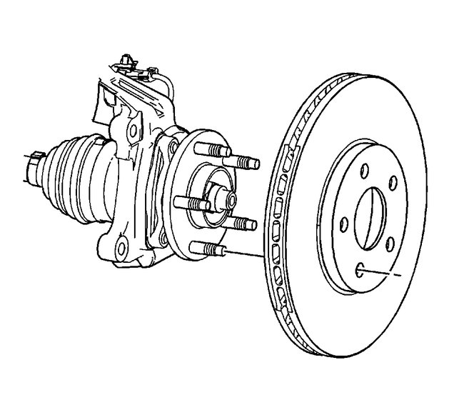

Here are the directions specific to your vehicle. The attached pics correlate with the directions.
Brake Pads Replacement - Front
Caution: Refer to Brake Dust Caution in Service Precautions.
Caution: Refer to Brake Fluid Irritant Caution in Service Precautions.
Removal Procedure
1. Inspect the fluid level in the brake master cylinder auxiliary reservoir.
2. If the brake fluid level is midway between the maximum-full point and the minimum allowable level, no brake fluid needs to be removed from the reservoir before proceeding.
3. If the brake fluid level is higher than midway between the maximum-full point and the minimum allowable level, remove brake fluid to the midway point before proceeding.
4. Raise and support the vehicle. Refer to Vehicle Lifting.

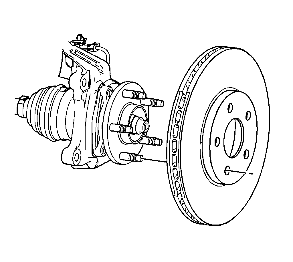

5. Remove the tire and wheel assembly.
6. Install and firmly hand tighten 2 wheel nuts to opposite wheel studs in order to retain the rotor to the hub.

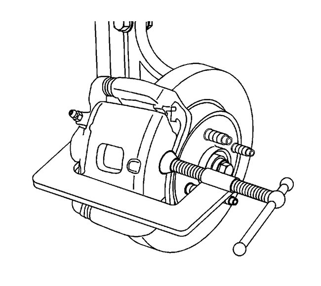

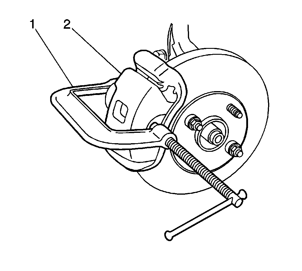

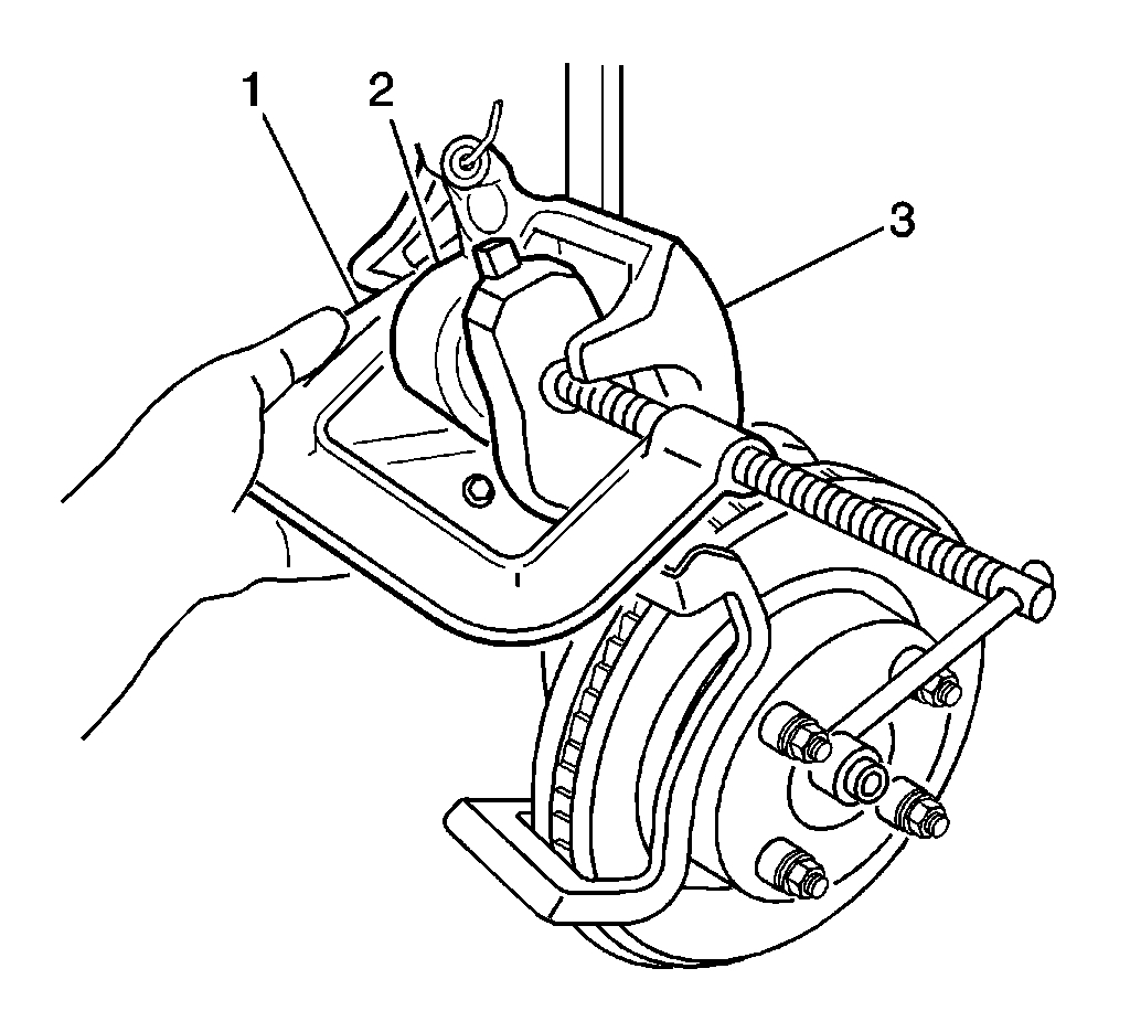

7. Install a large C-clamp (1) over the body of the brake caliper (2) with the C-clamp ends against the rear of the caliper body and against the outboard brake pad.
8. Tighten the C-clamp evenly until the caliper piston is compressed into the caliper bore enough to allow the caliper to slide past the brake rotor.
9. Remove the C-clamp from the caliper.

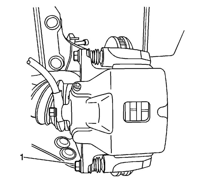

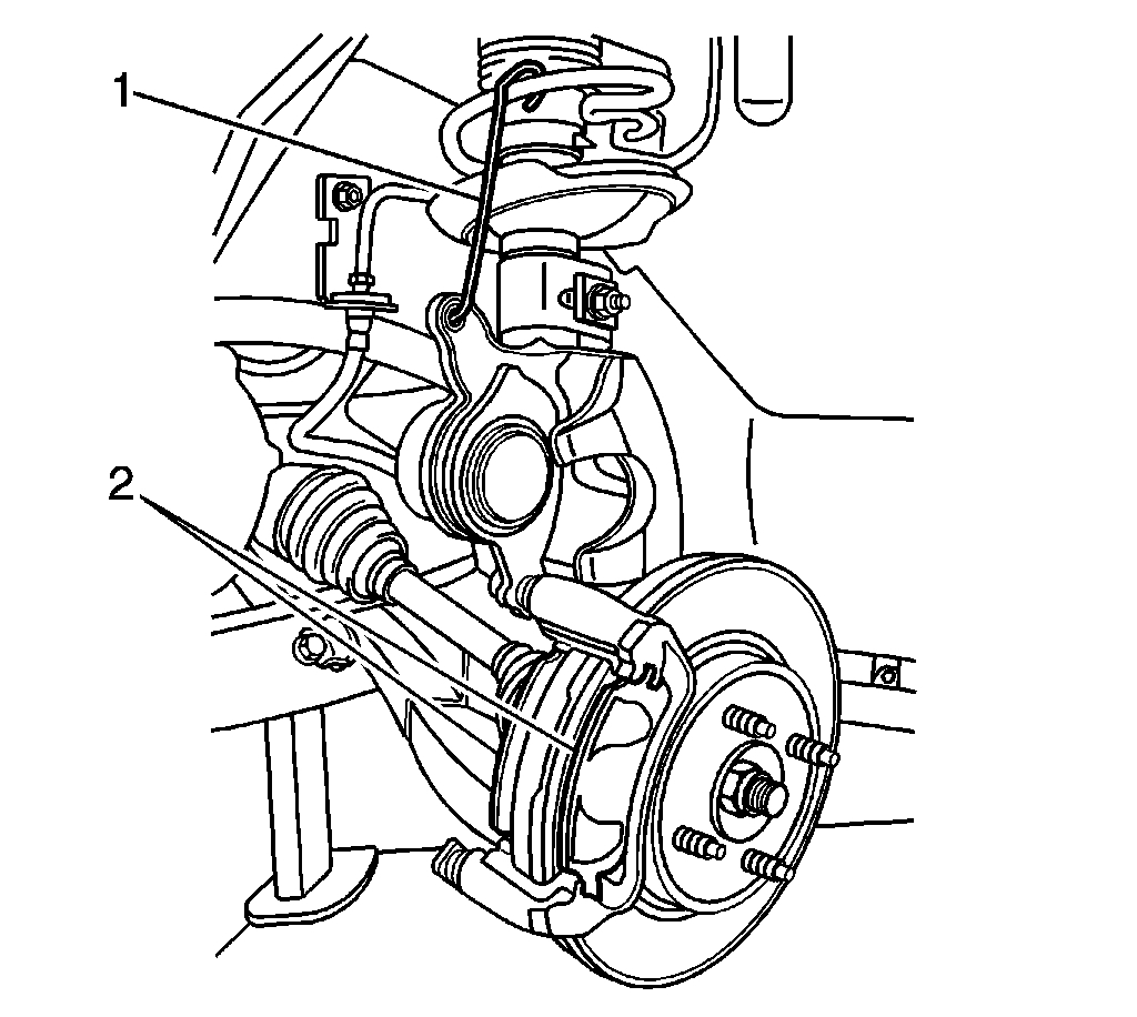

10. Remove the brake caliper lower guide pin bolt (1).
Notice: Support the brake caliper with heavy mechanic's wire, or equivalent, whenever it is separated from its mount and the hydraulic flexible brake hose is still connected. Failure to support the caliper in this manner will cause the flexible brake hose to bear the weight of the caliper, which may cause damage to the brake hose and in turn may cause a brake fluid leak.
11. Without disconnecting the hydraulic brake flexible hose, pivot the caliper upward and secure the caliper with heavy mechanics wire (1), or equivalent.

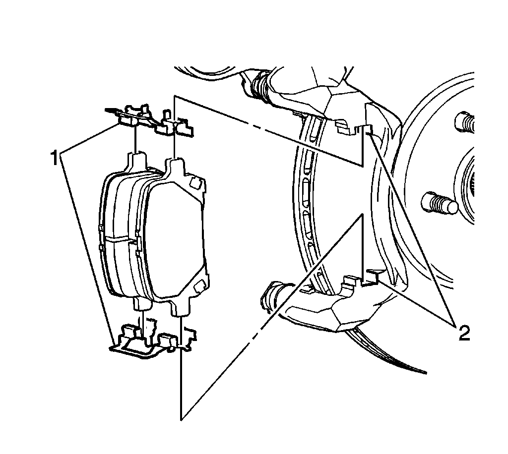

12. Remove the brake pads from the caliper mounting bracket.
13. Remove the brake pad retainers (1) from the caliper bracket.
14. Thoroughly clean the brake pad hardware mating surfaces of the caliper bracket (2), of any debris and corrosion.

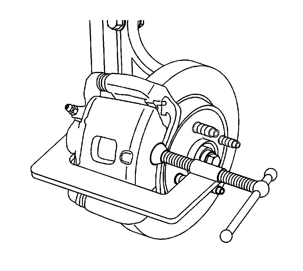

17. Install a large C-clamp (1) over the body of the brake caliper (3), with the C-clamp ends against the rear of the caliper body and against an old inboard brake pad (2) or a wood block installed against the caliper piston.
18. ^ Tighten the C-clamp (1) evenly until the caliper piston is compressed completely into the caliper bore.
19. Remove the C-clamp and the old brake pad or wood block from the caliper.

1. Apply a very thin coating of high temperature silicone brake lubricant to the pad hardware mating surfaces of the caliper bracket (2) only.
2. Install the brake pad retainers (1) to the brake caliper bracket.
Important: The wear sensor equipped disc brake pad must be mounted inboard of the rotor with the leading edge of the sensor facing the brake rotor during forward wheel rotation, or at the top of the pad when installed in vehicle position.
3. Install the brake pads to the caliper bracket.

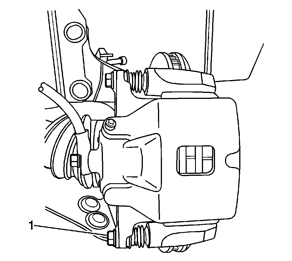

4. Remove the support, and rotate the brake caliper into position over the disc brake pads and to the caliper mounting bracket.
Notice: Refer to Fastener Notice in Service Precautions.
5. Install the lower brake caliper guide pin bolt (1).
^ Tighten the bolt to 34 Nm (25 ft. lbs.).
6. Remove the wheel nuts retaining the brake rotor to the hub.
7. Install the tire and wheel assembly.
